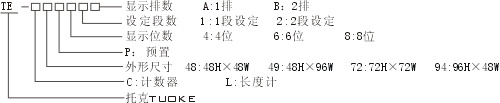

| Ò»¡¢ Ðͺż°º¬Òå |

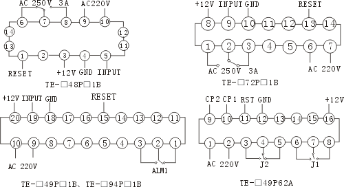

| <ËÄ¡¢ Á¬½Óͼ |

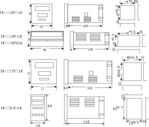

| °Ë¡¢ÍâÐμ°¿ª¿×³ß´ç |
