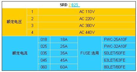

ÐͺÅ˵Ã÷ :
¹æ¸ñ˵Ã÷ :
µçÔ´µçѹ£ºµ¥Ïà(110¡¢220¡¢380¡¢440V)¡À15% 50/60Hz
¶î¶¨µçÁ÷£º18A£¬25A£¬35A£¬45A£¬60A
