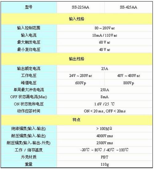

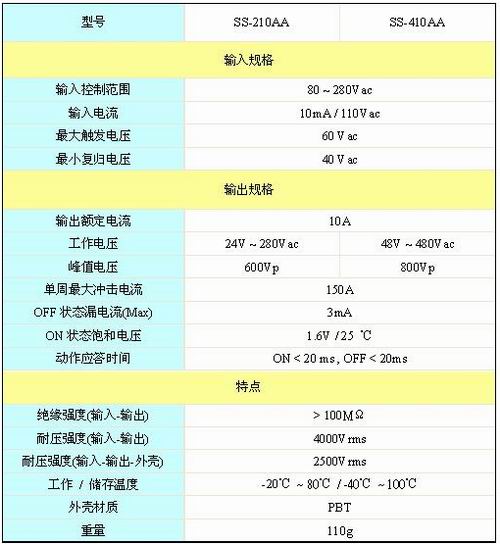

²úÆ·Ãû³Æ£º
̨Íåçùʤ£¨CONCH£©40 °²ÅàÝ”³ö ¹Ì̬¼ÌµçÆ÷
ÐÍ ºÅ£º
SS- x 40AA
²úÆ·½éÉÜ
SS- x 40AA 40 °²ÅàÊä³ö
¹¦ÄÜ˵Ã÷
ÌØµã£º
1. ²É¹âñîºÏ¸ôÀ룬ÊäÈë£Êä³öÄÍѹǿ¶È´ï£´KV
2. Áãµã´¥·¢·½Ê½±ÜÃâµç´Å / ¸ßƵ¸ÉÈÅ
3. ¾ß»º³å»ØÂ·¿ÉÒÔÎüÊÕ˲¼äÍ»²¨
4. ¸ßÄ͹ýµçÁ÷£¬¿ÉÓ¦ÓÃÓÚµÆÅÝ»òÂí´ï¸ºÔØ
5. ¸ß¿É¿¿ÐÔÊʺϳ¤Ê±¼äʹÓÃ
