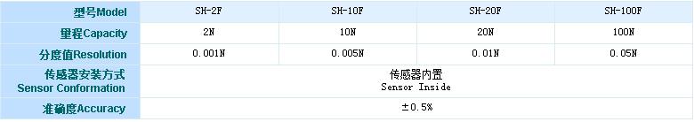

¸ß¾«¶È¸ß·Ö±æÂÊ£¬×¼È·¶È0.5¼¶£¬×îС¶ÁÊý´ï0.001N£»
רÓÃÓÚµçÄÔ¼üÅÌ¡¢°´¼ü°´Å¥µÄ°´Ñ¹Á¦²âÊÔ£¬²¢¿ÉÑ¡ÅäSPF°´¼üרÓòâÊÔ»ú¼Ü£¬×éºÏ³ÉרҵµÄ°´¼ü°´Å¥ÊÔÑé»ú£»
·åÖµ×Ô¶¯½â³ý¹¦ÄÜ£¬×¥È¡²âÊÔÖеķåÖµ£¬±£³ÖÏÔʾ1~10Ã루¿É×ÔÓÉÉ趨£©ºó×Ô¶¯½â³ý£¬µÈ´ýÏÂÒ»¸ö·åÖµ£¨ÊµÓÃÐÂÐÍרÀû£ºZL200520013022.2£©£»
±È½Ï¹¦ÄÜ£¬ÉÏÏÂÏÞÆ«²îÖµ×ÔÓÉÉ趨£¬ºìÂÌָʾµÆ¼°·äÃùÆ÷×Ô¶¯Éù¹â±¨¾¯ÉèÖã»
¼ÇÒ书ÄÜ£¬¿É´æ´¢10×é²âÊÔÊý¾Ý£¬Æ½¾ùÖµ¼ÆË㹦ÄÜ£»
ÈýÖÖµ¥Î»±ä»»£¬¿É»»N¡¢kgf¡¢lbfÈýÖּƲⵥ룬²¢×Ô¶¯»»Ë㣻

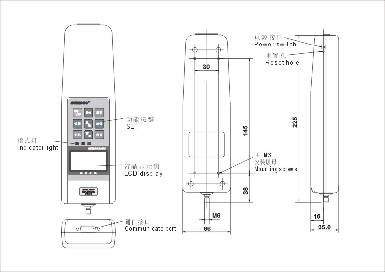

²Ù×÷¼òµ¥£¬¼¯¶à¹¦ÄÜÒ»ÌåÉè¼Æ£¬°´¼üÅäÖü°²Ù×÷¼òµ¥Ã÷ÁËʹÓ÷½±ã£¬²¢¿É°²×°ÓÚ¸÷ÖÖÊÔÑé»ų́¼°¼Ð¾ß×÷ΪרÓÃÊÔÑé»úʹÓá£
