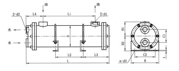

238 | ÍâÐγߴç
ÐͺŠ|
L |
L1 |
L2 |
L3 |
L4 |
B |
C1 |
C2 |
D |
H1 |
H2 |
t |
d1 |
d2 |
n-d3 |
GLC1-0.4 |
383 |
240 |
145 |
116 |
75 |
132 |
48 |
102 |
83 |
68 |
74 |
2 |
G1 |
G3/4 |
4-§¶9 |
GLC1-0.6 |
548 |
405 |
310 |
GLC1-0.8 |
678 |
532 |
435 |
GLC1-1.0 |
808 |
665 |
570 |
GLC1-1.2 |
948 |
805 |
715 |
GLC2-1.3 |
542 |
374 |
225 |
153 |
90 |
170 |
78 |
138 |
121 |
87 |
96 |
2 |
G1 |
G1 |
4-§¶11 |
GLC2-1.7 |
668 |
500 |
350 |
GLC2-2.1 |
802 |
634 |
485 |
GLC2-2.6 |
944 |
776 |
630 |
GLC2-3.0 |
1094 |
926 |
780 |
GLC2-3.5 |
1252 |
1084 |
935 |
GLC3-4 |
815 |
570 |
380 |
203 |
136 |
210 |
100 |
170 |
168 |
109 |
117 |
2 |
G11/2 |
G11/4 |
4-§¶15 |
GLC3-5 |
965 |
720 |
530 |
GLC3-6 |
1115 |
870 |
680 |
GLC3-7 |
1285 |
1040 |
856 |
GLC3-8 |
1445 |
1200 |
1010 |
G2 |
G11/2 |
GLC3-9 |
1605 |
1360 |
1170 |
GLC3-10 |
1775 |
1530 |
1340 |
GLC3-11 |
1955 |
1710 |
1520 |
GLC4-13 |
1270 |
985 |
745 |
248 |
156 |
270 |
130 |
220 |
219 |
137 |
150 |
3 |
G2 |
G2 |
4-§¶19 |
GLC4-15 |
1430 |
1145 |
905 |
GLC4-17 |
1590 |
1305 |
1065 |
GLC4-19 |
1760 |
1475 |
1235 |
GLC4-21 |
1940 |
1655 |
1415 |
GLC4-23 |
2110 |
1825 |
1585 |
GLC4-25 |
2290 |
2005 |
1765 |
GLC4-27 |
2460 |
2175 |
1935 | | | | |
