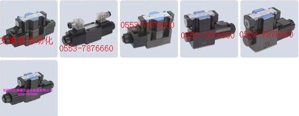

  DSG£­01ϵÁеç´Å»»Ïò·§
±¾ÏµÁÐÔª¼þÅäÓÐÇ¿ÎüÁ¦µÄʪʽµç´ÅÌú£¬Ó͵ÀÉè¼ÆºÏÀí£¬¾ßÓиßѹ£¬´óÁ÷Á¿£¬Ñ¹Á¦ËðʧµÍµÈÌØµã¡£ÒòΪÊÇʪʽµç´ÅÌú£¬ËùÒÔÊÙÃü´ó£¬ÔëÉùµÍ£¬²¢ÇÒ²»ÏòÍⲿ©ÓÍ¡£
 ³£¹æÐÍÄܹ»ÔÚ¸ßѹ(315kgf/cm2){31.5MPa}¡¢´óÁ÷Á¿(63L/min)µÄ³¡ºÏʹÓá£
 ¶¯×÷Îȶ¨µç´ÅÌúÎüÁ¦ºÍ»¬·§µ¯»ÉÁ¦´ó£¬¹ÊÄÍÎÛ¹¸£¬¶¯×÷Îȶ¨¡¢¿É¿¿¡£
