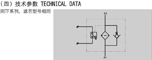

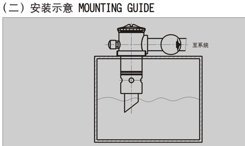

²úÆ·¼ò½é£º ±¾¹ýÂËÆ÷½ö¿É°²×°ÔÚÓÍÏäµÄÉϲ¿£¬ÎüÓÍͲÌå½þÈëÓÍÏäÄÚÒºÃæÒÔÏ£¬ÆäËüÐÔÄܾùÓë¹ÏϵÁÐÏàËÆ£¬µ«ÎÞ×Ô·â·§¡£

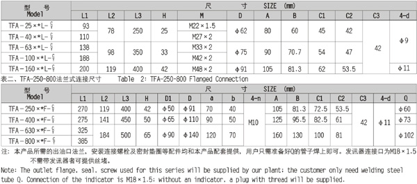

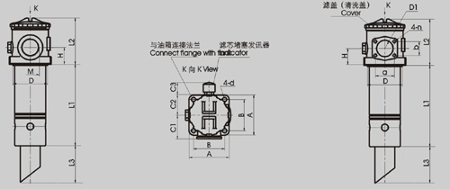

±íÒ»¡¢TFA-25¡«160ÂÝÎÆÊ½Á¬½Ó³ß´ç
ÐͺÅ
³ß´ç£¨mm£©
L1
L2
L3
H
M
D
A
B
C1
C2
C3
4-d
TF-25¡Á*L-¡õ
93
78
36
25
M22¡Á1.5
¦Õ62
80
60
45
42
42
¦Õ9
TF-40¡Á*L-¡õ
110
M27¡Á2
TF-63¡Á*L-¡õ
138
98
40
33
M33¡Á2
¦Õ75
90
70.7
54
47
TF-100¡Á*L-¡õ
188
M42¡Á2
TF-160¡Á*L-¡õ
200
119
53
42
M48¡Á2
¦Õ91
105
81.3
62
53.5
¦Õ11
±í¶þ¡¢TF-250¡«800·¨À¼Ê½Á¬½Ó³ß´ç
ÐͺÅ
³ß´ç£¨mm£©
L1
L2
L3
H
D1
D
a
b
4-n
A
B
C1
C2
C3
4-d
Q
TF-250¡Á*F-¡õ
270
119
53
42
¦Õ50
¦Õ91
70
40
M10
105
81.3
72.5
53.5
42
¦Õ11
¦Õ60
TF-400¡Á*F-¡õ
275
141
60
¦Õ65
¦Õ110
90
125
95.5
82.5
61
¦Õ73
TF-630¡Á*F-¡õ
325
184
55
65
¦Õ90
¦Õ140
120
70
160
130
100
81
¦Õ102
TF-800¡Á*F-¡õ
385
