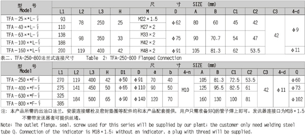

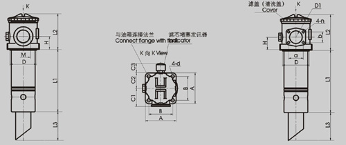

±íÒ»¡¢TFA-25¡«160ÂÝÎÆÊ½Á¬½Ó³ß´ç
ÐͺŠ|
³ß´ç£¨mm£© |
L1 |
L2 |
L3 |
H |
M |
D |
A |
B |
C1 |
C2 |
C3 |
4-d |
TF-25¡Á*L-¡õ |
93 |
78 |
36 |
25 |
M22¡Á1.5 |
¦Õ62 |
80 |
60 |
45 |
42 |
42 |
¦Õ9 |
TF-40¡Á*L-¡õ |
110 |
M27¡Á2 |
TF-63¡Á*L-¡õ |
138 |
98 |
40 |
33 |
M33¡Á2 |
¦Õ75 |
90 |
70.7 |
54 |
47 |
TF-100¡Á*L-¡õ |
188 |
M42¡Á2 |
TF-160¡Á*L-¡õ |
200 |
119 |
53 |
42 |
M48¡Á2 |
¦Õ91 |
105 |
81.3 |
62 |
53.5 |
¦Õ11 |
±í¶þ¡¢TF-250¡«800·¨À¼Ê½Á¬½Ó³ß´ç
ÐͺŠ|
³ß´ç£¨mm£© |
L1 |
L2 |
L3 |
H |
D1 |
D |
a |
b |
4-n |
A |
B |
C1 |
C2 |
C3 |
4-d |
Q |
TF-250¡Á*F-¡õ |
270 |
119 |
53 |
42 |
¦Õ50 |
¦Õ91 |
70 |
40 |
M10 |
105 |
81.3 |
72.5 |
53.5 |
42 |
¦Õ11 |
¦Õ60 |
TF-400¡Á*F-¡õ |
275 |
141 |
60 |
50 |
¦Õ65 |
¦Õ110 |
90 |
50 |
125 |
95.5 |
82.5 |
61 |
¦Õ73 |
TF-630¡Á*F-¡õ |
325 |
184 |
55 |
65 |
¦Õ90 |
¦Õ140 |
120 |
70 |
160 |
130 |
100 |
81 |
¦Õ102 |
TF-800¡Á*F-¡õ |
385 |
