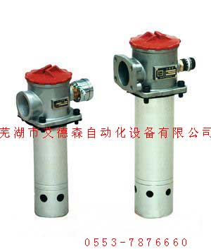

²úÆ·Ãû³Æ£º
TF-25,TF-40,TF-100,TF-160,TF-250ÏäÍâ×Ô·âʽÎüÓ͹ýÂËÆ÷
ÐÍ ºÅ£º
0.00
2614
Ïêϸ˵Ã÷£º
TFϵÁÐÏäÍâ×Ô·âʽÎüÓ͹ýÂËÆ÷£¨´úÌæLXZϵÁУ©
| ²úÆ·Ãû³Æ£º |
TFϵÁÐÏäÍâ×Ô·âʽÎüÓ͹ýÂËÆ÷ |
| ²úÆ·¼ò½é£º |
±¾¹ýÂËÆ÷°²×°ÔÚÓͱÃÎüÓͿڴ¦£¬ÓÃÒÔ±£»¤Óͱü°ÆäËüҺѹԪ¼þ£¬ÒÔ±ÜÃâÎüÈëÎÛȾÔÓÖÊ£¬ÓÐЧµØ¿ØÖÆÒºÑ¹ÏµÍ³ÎÛȾ£¬Ìá¸ßҺѹϵͳµÄÇå½à¶È¡£ ±¾¹ýÂËÆ÷¿ÉÖ±½Ó°²×°ÔÚÓÍÏä²à±ß£¬Éϲ¿»òµ×²¿£¬ÎüÓÍͲÌå½þÈëÓÍÏäÄÚÒºÃæÒÔÏ£¬¹ýÂËÆ÷ÂËͷ¶ÔÚÓÍÏäÍ⣬²¢ÉèÓÐ×Ô·â·§£¬ÅÔͨ·§£¬ÂËоÎÛȾ¶ÂÈû·¢Ñ¶Æ÷µÈ×°Öã¬Ê¹¸ü»»ÂËоºÍÇåÏ´ÂËоʱÓÍÏäÄÚÓÍÒº²»»áÁ÷³ö£¬±¾²úÆ·Éè¼ÆÐÂÓ±£¬°²×°·½±ã£¬Í¨ÓÍÄÜÁ¦´ó£¬×èÁ¦Ð¡£¬ÇåÏ´»ò¸ü»»ÂËо·½±ãµÈÓŵ㡣 |

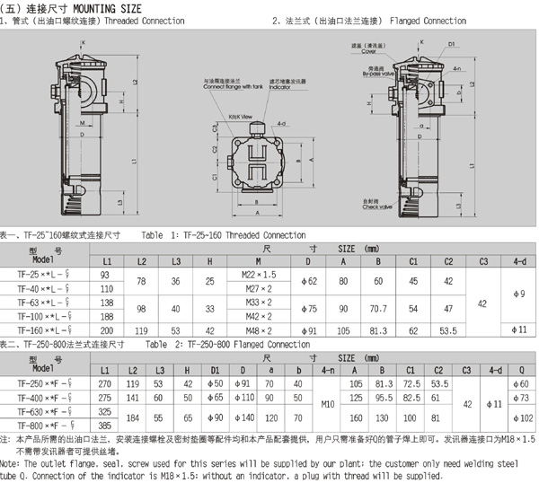

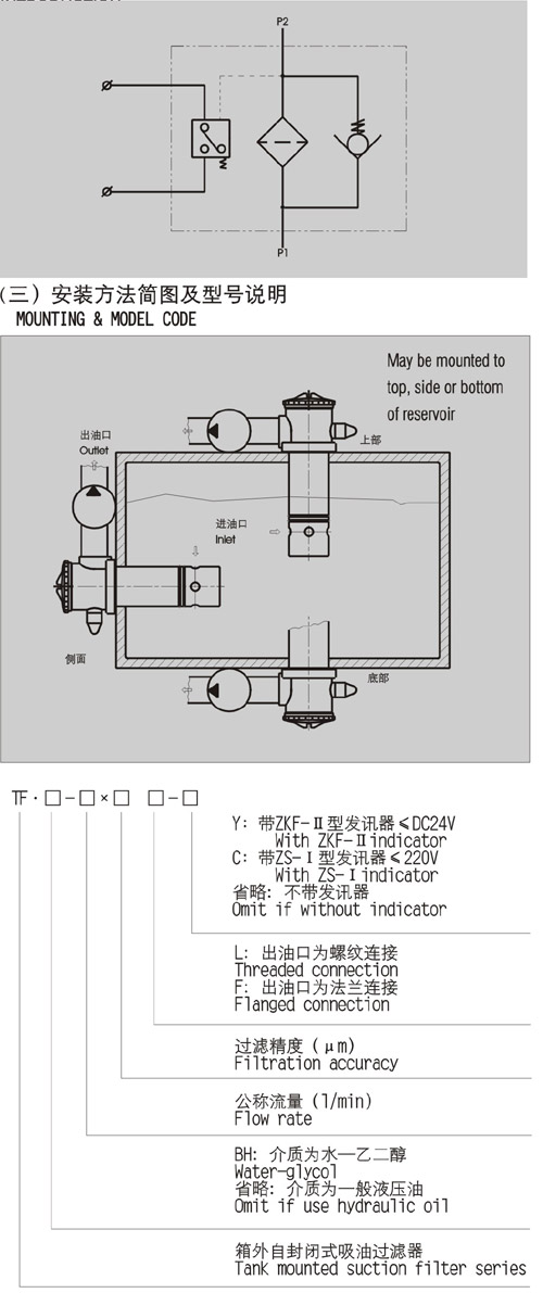

×¢£º*Ϊ¹ýÂ˾«¶È£¬ÈôʹÓýéÖÊΪˮһÒÒ¶þ´¼£¬´ø·¢Ñ¶Æ÷£¬Ôò¹ýÂËÆ÷ÐͺÅΪTF¡¤BH-160¡Á*L-C£¬ÂËоÐͺÅΪTFX¡¤BH-160¡Á*
±íÒ»¡¢TF-25¡«160ÂÝÎÆÊ½Á¬½Ó³ß´ç
ÐͺŠ|
³ß´ç£¨mm£© |
L1 |
L2 |
L3 |
H |
M |
D |
A |
B |
C1 |
C2 |
C3 |
4-d |
TF-25¡Á*L-¡õ |
93 |
78 |
36 |
25 |
M22¡Á1.5 |
¦Õ62 |
80 |
60 |
45 |
42 |
42 |
¦Õ9 |
TF-40¡Á*L-¡õ |
110 |
M27¡Á2 |
TF-63¡Á*L-¡õ |
138 |
98 |
40 |
33 |
M33¡Á2 |
¦Õ75 |
90 |
70.7 |
54 |
47 |
TF-100¡Á*L-¡õ |
188 |
M42¡Á2 |
TF-160¡Á*L-¡õ |
200 |
119 |
53 |
42 |
M48¡Á2 |
¦Õ91 |
105 |
81.3 |
62 |
53.5 |
¦Õ11 | |
±í¶þ¡¢TF-250¡«800·¨À¼Ê½Á¬½Ó³ß´ç
ÐͺŠ|
³ß´ç£¨mm£© |
L1 |
L2 |
L3 |
H |
D1 |
D |
a |
b |
4-n |
A |
B |
C1 |
C2 |
C3 |
4-d |
Q |
TF-250¡Á*F-¡õ |
270 |
119 |
53 |
42 |
¦Õ50 |
¦Õ91 |
70 |
40 |
M10 |
105 |
81.3 |
72.5 |
53.5 |
42 |
¦Õ11 |
¦Õ60 |
TF-400¡Á*F-¡õ |
275 |
141 |
60 |
50 |
¦Õ65 |
¦Õ110 |
90 |
50 |
125 |
95.5 |
82.5 |
61 |
¦Õ73 |
TF-630¡Á*F-¡õ |
325 |
184 |
55 |
65 |
¦Õ90 |
¦Õ140 |
120 |
70 |
160 |
130 |
100 |
81 |
¦Õ102 |
TF-800¡Á*F-¡õ |
385 | ×¢£º±¾²úÆ·ËùÐèµÄ³öÓͿڷ¨À¼£¬°²×°Á¬½ÓÂÝ˨¼°ÃÜ·âµæÈ¦µÈÅä¼þ¾ùºÍ±¾²úÆ·ÅäÌ×Ìṩ£¬Óû§Ö»Ðè×¼±¸ºÃQµÄ¹Ü×Óº¸Éϼ´¿É¡£·¢Ñ¶Æ÷Á¬½Ó¿ÚΪM18¡Á1.5²»Ðè´ø·¢Ñ¶Æ÷Õß¿ÉÌṩ˿¶Â¡£ | |
