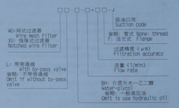

WU¡¢XUϵÁÐÎüÓ͹ýÂËÆ÷ £¨Ò»£©ÐÔÄÜÓÃ;£º ¸Ã¹ýÂËÆ÷ÊôÓÚ´Ö¹ýÂËÆ÷£¬Ò»°ã°²×°ÔÚÓͱõÄÎüÓͿڴ¦£¬ÓÃÒÔ±£»¤ÓͱñÜÃâÎüÈë½Ï´óµÄ»úеÔÓÖÊ¡£¸Ã¹ýÂËÆ÷½á¹¹¼òµ¥£¬Í¨ÓÍÄÜÁ¦´ó×èÁ¦Ð¡£¬²¢ÉèÓйÜʽ¡¢·¨À¼Ê½Á¬½Ó£¬·ÖÍøÊ½¡¢Ïß϶ʽÁ½ÖÖ¡£
(¶þ)ÐͺÅ˵Ã÷:
(Èý)¼¼Êõ²ÎÊý£º
