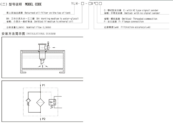

YLHϵÁÐÏäÉÏ»ØÓ͹ýÂËÆ÷
²úÆ·Ãû³Æ£º YLHϵÁÐÏäÉÏ»ØÓ͹ýÂËÆ÷
²úÆ·¼ò½é£º ±¾¹ýÂËÆ÷ÊÊÓÃÓÚҺѹϵͳ»ØÓ;«¹ýÂË£¬ ÓÃÒÔÂ˳ýҺѹϵͳÖÐÓÉÓÚÔª¼þÄ¥Ëð²úÉúµÄ½ðÊô¿ÅÁ£ºÍÃÜ·âµÄÏð½ºÔÓÖʵÈÎÛȾÎʹÁ÷»ØÓÍÏäµÄÓÍÒº±£³ÖÇå½à¡£ ¹ýÂËÆ÷ÅäÓз¢Ñ¶Æ÷£¬ÅÔͨ·§ºÍ¼¯ÎÛÖÑ¡£ Ö÷ÒªÐÔÄÜÌØµãÓУº 1£®¹ýÂËÆ÷Ö±½Ó°²×°ÔÚÓÍÏä¸Ç°åÉÏ£¬Í²ÌåÉìÈëÓÍÏäµÄÓÍÒºÖС£½øÓÍ¿ÚÉèÓÐÂÝÎÆºÍ·¨À¼Á¬½Ó·½Ê½£¬Óë»ØÓ͹Ü·Á¬½Ó£¬¹Ü·¼òµ¥£¬°²×°·½±ã¡£ 2£®µ±ÂËо¶ÂÈûʱ£¬Ö»Ðè´ò¿ªÉϸǣ¬ ¼´¿ÉÈ¡³öÂËо£¬ µ±¸ü»»ÂËоºó×°ÉÏÉϸǣ¬±ã¿ÉͶÈëÔËÐУ¬Ê®·Ö·½±ã¡£ 3£®ÔÚ¹ýÂËÆ÷½øÓÍ¿ÚÉèÓÐÂËо¶ÂÈû·¢Ñ¶Æ÷£¬¾ßÓÐÖ±¹ÛºÍ·¢Ñ¶Á½ÖÖ¹¦ÄÜ¡£Í¨¹ý¹Û²ì·¢Ñ¶Æ÷ָʾ±í£¬¿ÉÒÔËæÊ±Á˽âÂËо¶ÂÈûÇé¿ö¡£µ±ÂËо¶ÂÈû£¬½øÓÍ¿ÚѹÁ¦´ïµ½¼¼Êõ²ÎÊý±íÖй涨ֵʱ£¬·¢Ñ¶Æ÷±ã»á·¢³öѶºÅ.

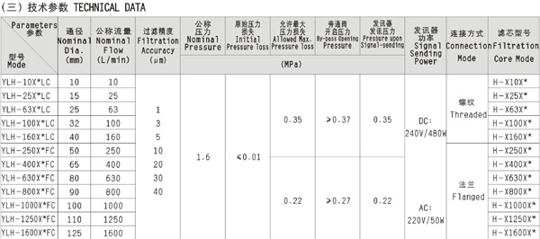

Î壩¼¼Êõ²ÎÊý£º

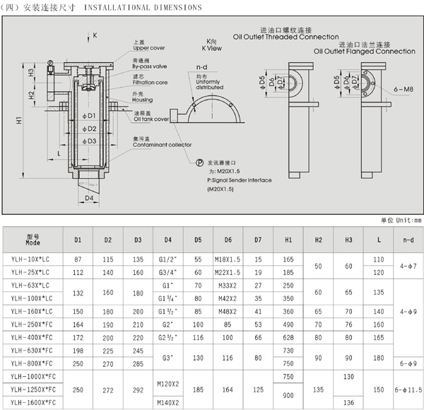

ÐͺÅ
ͨ¾¶(mm)
¹«³ÆÁ÷Á¿(L/min)
¹ýÂ˾«¶È(¦Ìm)
¹«³ÆÑ¹Á¦
ԭʼѹÁ¦Ëðʧ
ÔÊÐí×î´óѹÁ¦Ëðʧ
ÅÔͨ·§¿ªÆôѹÁ¦
·¢Ñ¶Æ÷·¢Ñ¶Ñ¹Á¦
·¢Ñ¶Æ÷¹¦ÂÊ
Á¬½Ó·½Ê½
ÂËоÐͺÅ
£¨MPa£©
YLH-10¡Á*LC
10
10
1
3
5
10
20
30
40
1.6
¡Ü0.01
0.35
¡Ý0.37
0.35
DC:240V/480W
AC:220V/50W
ÂÝÎÆ
H-X10X*
YLH-25¡Á*LC
15
25
H-X25X*
YLH-63¡Á*LC
25
63
H-X63X*
YLH-100¡Á*LC
32
100
H-X100X*
YLH-160¡Á*LC
40
160
H-X160X*
YLH-250¡Á*FC
250
·¨À¼
H-X250X*
YLH-400¡Á*FC
65
400
0.22
¡Ý0.27
0.22
H-X400X*
YLH-630¡Á*FC
80
630
H-X630X*
YLH-800¡Á*FC
90
800
H-X800X*
YLH-1000¡Á*FC
100
1000
H-X1000X*
YLH-1250¡Á*FC
110
1250
H-X1250X*
YLH-1600¡Á*FC
125
1600
H-X1600X*
×¢£º*Ϊ¹ýÂ˾«¶È£¬ÈôÑ¡Óù¤×÷½éÖÊΪˮһÒÒ¶þ´¼£¬Á÷Á¿Îª100L/min£¬¹ýÂ˾«¶ÈΪ3¦Ìm£¬´ø·¢Ñ¶Æ÷µÄ¹ýÂËÆ÷£¬ÆäÐͺÅÔò±êΪ£ºYLH¡¤BH-100X3C
