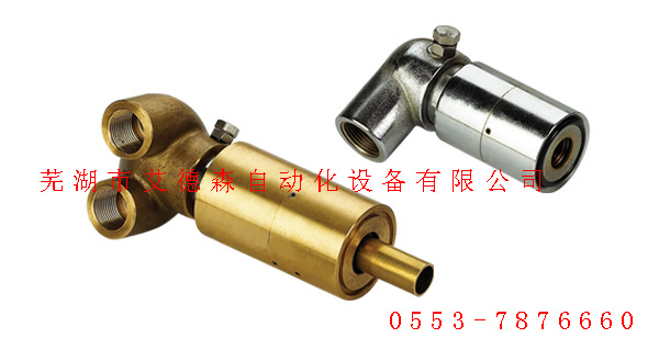

²úÆ·Ãû³Æ£º XZ-1.20 XZ-2.20Ðýת½ÓÍ·

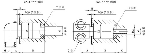

ÍâÐγߴç
ÐͺÅ
M
A
B
C
D1
D2
d
H
h
OÐÎȦ
ÖØÁ¿£¨kg£©
XZ-1.20
RC3/4
33
68.5
§¶47
§¶20~25
10
6
38¡Á3.5
0.80
XZ-1.20
RC3/4
42
99
40
§¶58
20
§¶30~35
10
6
51¡Á3.5
2.63

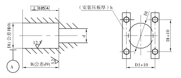

°²×°²Î¿¼Í¼
