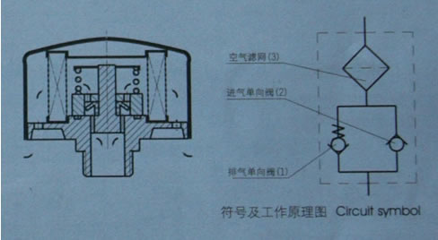

PAFϵÁвúÆ·ÊÊÓÃÓÚ¹¤³Ì»úе¡¢³µÁ¾¡¢Òƶ¯»úеÒÔ¼°ÐèÒª¾ßÓÐѹÁ¦µÄҺѹϵͳÓÍÏäÅäÌ×ʹÓᣱ¾²úÆ·ÓÉ¿ÕÆø¹ýÂËÆ÷¡¢½øÆøµ¥Ïò·§¡¢ÅÅÆøµ¥Ïò·§¡¢¼ÓÓ͹ýÂËÆ÷ËIJ¿·Ö×é³É£¬´Ó¶ø¼ò»¯ÁËÓÍÏäµÄ½á¹¹£¬ÓÖÓÐÀûÓÚÓÍÒºµÄ¾»»¯¡£µ±ÒºÑ¹ÏµÍ³¹¤×÷ʱÓÍÏäÄÚµÄÒºÃæ²»Ê±ÉÏÉý»òϽµ£¬Ï½µÊ±PAF²úÆ·ÎüÈë¿ÕÆø£¬¾­¹ýÂËÍø¡¾3¡¿×Ô¶¯½øÈë½øÆøµ¥Ïò·§¡¾2¡¿£¬½øÈëÓÍÏ䣬´ËʱÏäÄÚѹÁ¦Ð¡ÓÚÔ¤¶¨Ñ¹Á¦£¬ÅÅÆøµ¥Ïò·§¡¾1¡¿´¦ÓڹرÕ״̬£¬Äܱ£³ÖÓÍÏäÄÚÔ¤¶¨Ñ¹Á¦£¬Ìá¸ßÓͱõÄ×ÔÎüÄÜÁ¦£¬Î¬³ÖÓÍÏäÄÚÒºÌåµÄƽÎÈ£¬±ÜÃâÓÍÏäÄÚÒºÌåÒòÕñµ´»òɧ¶¯¶ø²úÉú±Ã¿ÉÄܳöÏÖµÄÎü¿ÕµÈ¹ÊÕÏ¡£µ±¹¤×÷Ñ­»·ºóÁ÷»ØÓÍÏäÊ¹ÒºÃæÉÏÉý£¬¹¤×÷ÓÍҺζÈÒ²Ëæ×ÅÉý¸ß£¬Éú³ÉÁËÓÍÎíÆøÌå²¢Ôö¼ÓÁËÓÍÏäÄÚµÄѹÁ¦£»µ±ÓÍÏäÄÚµÄѹÁ¦´óÓÚÔ¤¶¨Ñ¹Á¦Ê±£¬ÅÅÆøµ¥Ïò·§¡¾1¡¿×Ô¶¯¿ªÆôÏòÍâÅÅÆø£¬Ö±µ½ÏäÄÚѹÁ¦µÈÓÚÔ¤¶¨Ñ¹Á¦Ê±£¬ÅÅÆøµ¥Ïò·§¡¾1¡¿²Å×Ô¶¯¹Ø±Õ¡£ÕâÑùÀ´»ØÑ­»·¼ÈÄܱ£»¤ÒºÑ¹ÏµÍ³Õý³£¹¤×÷µÄ×÷Óã¬ÓÖÄÜÑÓ³¤ÓÍÒº¼°Ôª¼þµÄ¹¤×÷ÖÜÆÚºÍʹÓÃÊÙÃü¡£

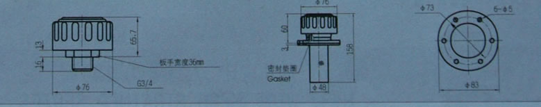

        1¡¢ÂÝÎÆÁ¬½Ó                                  2¡¢·¨À¼Á¬½Ó
