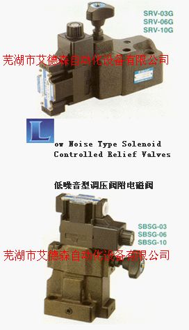

olenoid Controlled Relief Valves
¶þ¶ÎѹÁ¦¡¢Èý¶ÎѹÁ¦µ÷ѹ·§¸½µç´Å·§
Ñ¡¹ºÖ¸ÄÏ HOW TO ORDER
SRV 06 G 2B3A A1
ϵÁбàºÅ
SERIES NUMBER
³Æºô¿Ú¾¶
VALVE SIZE
½ÓÐøÐÍʽ
TYPE OF CONNECTION
G£ºSUB-PLATE TYPE
T£ºTHREADED TYPE
йѹÐÍʽ
TYPE OF FUNCTIONS FOR OPTIONAL VENTING CONDITIONS
ÏßȦÐÍʽSOLENDID TYPE
A1£ºAC11OV£¬D1£ºDC12V£¬A2£ºAC22OV£¬D2£ºDC24V£¬A3£ºAC38OV
ÐÔÄÜ±í  SPECIFICATION
ÐÍʽ  MODEL
ѹÁ¦µ÷Õû·¶Î§PRESSURE
ADJ.RANGE£¨kgf/cm2£©
×î¸ßʹÓÃѹÁ¦MAX.OPERATED
PRESSURE£¨kgf/cm2£©
×î´óÁ÷Á¿MAX.FLOW
l/min
ÖØÁ¿
WEIGHT
£¨kg£©
×ùµæÐÍ
SUB-PLATE TYPE
Åä¹ÜÐÍTHREAD TYPE
SRV-03G-2P ¡¡ B£º7-70
C£º35-140
H£º70-210
250 100 10 ¡¡
SRV-03G-3P ¡¡ 100 10 ¡¡
SRV-06G-2P SRV-06T-2P 200 11 9
SRV-06G-3P SRV-06T-3P 200 11 9
SRV-10G-2P SRV-10T-2P 400 13.7 13
SRV-10G-3P SRV-10T-3P 400 13.7 13
SRV-03G ¡¡ 100 7.1 ¡¡
SRV-06G SRV-06T 200 8.0 7.4
SRV-10G SRV-10T 400 11.3 11.1
SBSG-03 ¡¡ 100 6.3 ¡¡
SBSG-06 ¡¡ 200 7.2 ¡¡
SBSG-10 ¡¡ 400 12.7
olenoid Controlled Relief Valves(THREAD Type)
µ÷ѹ·§¸½µç´Å·§£¨Åä¹Üʽ£©
olenoid Controlled Relief Valves(SUB-PLATE Type)
µ÷ѹ·§¸½µç´Å·§£¨×ùµæÊ½£©
ÐÍʽ
MODEL
ÓÍѹͼ¼ÇºÅ
GRAPHICAL
SYMBOL
ÏßȦ¼¤´ÅÓ뵼ѹ¶¯×÷״̬
FUNCTIONS OF COIL & VENTINGS
ÏßȦA
COIL A
ÏßȦB
COIL B
µ¼Ñ¹¿×¶¯×÷״̬
2B3A
ON
OFF A¿×A PORT
ON ÓͲۣ¨Ð¶ÔØ£©TANK£¨UNL OADING£©
2B3B ON OFF ÓͲۣ¨Ð¶ÔØ£©TANK£¨UNL OADING£©
ON B¿× B PORT
2B2B ON OFF
±Õ״̬£¨µ÷ѹ·§É趨£©
PRESSURE FOLLOWING RELIEF
ON B¿× B PORT
2B2 ON OFF ÓͲۣ¨Ð¶ÔØ£©TANK£¨UNL OADING£©
ON B¿× B PORT
3C2 OFF OFF ±Õ״̬£¨µ÷ѹ·§É趨£©
ON OFF A¿×A PORT
OFF ON B¿× B PORT
3C3 OFF OFF ÓͲۣ¨Ð¶ÔØ£©TANK£¨UNL OADING£©
ON OFF A¿×A PORT
OFF ON B¿× B PORT
