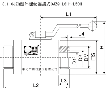

L1
L2
L3
L4
H
D1
D2
¡õS
DM
      CJZQ-L6H
6
100
82
12
1.28
76
6
11
44
M16¡Á1.5
0.7
      CJZQ-L8H
8
100
86
14
1.97
76
8
16
44
M22¡Á1.5
1.0
      CJZQ-L10H
10
130
100
16
1.97
86
10
20
52
M27¡Á1.5
1.8
      CJZQ-L15H
15
130
105
18
1.97
90
15
25
56
M30¡Á1.5
2.0
      CJZQ-L20H
20
170
121
20
1.97
110
20
30
65
M36¡Á2
3.1
      CJZQ-L25H
25
170
135
22
1.97
120
24
35
75
M42¡Á2
4.0
      CJZQ-L32H
32
210
160
24
1.97
135
30
40
88
M52¡Á2
7.3
      CJZQ-L40H
40
210
180
26
1.97
142
38
96
M60¡Á2
8.8
      CJZQ-L50H
250
205
28
2.75
170
48
60
120
M72¡Á2
15.5

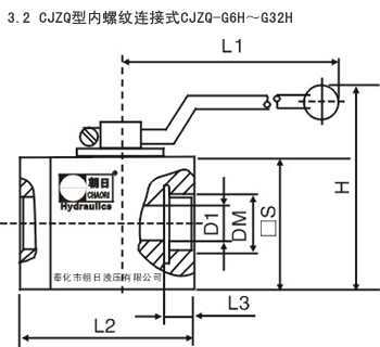

ÐͺÅ
£¨Model£©
DN
£¨mm£©
»ù±¾³ß´ç
ÖØÁ¿
£¨Kg£©
L1
L2
L3
H
D1
¡õS
DM
       CJZQ-G6H
6
100
68
12
76
6
44
M14¡Á1.5
0.7
       CJZQ-G8H
8
100
70
14
76
8
44
M16¡Á1.5
1.0
       CJZQ-G10H
10
130
88
16
86
10
52
M18¡Á1.5
1.8
       CJZQ-G15H
15
130
91
18
90
15
56
M27¡Á2
2.0
       CJZQ-G20H
20
170
100
20
110
20
65
M33¡Á2
3.2
       CJZQ-G25H
25
170
111
22
120
34
75
M42¡Á2
4.2
       CJZQ-G32H
32
210
131
24
135
30
88
M48¡Á2
7.6

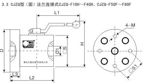

ÐͺÅ
£¨Model£©
DN
£¨mm£©
»ù±¾³ß´ç
ÖØÁ¿
£¨Kg£©
L1
L2
L3
H
D1
¡õS
¡õS1
4-M
D
GJZQ-F10H
10
130
70
22
86
10
52
33
M8
73
2.1
GJZQ-F15H
15
130
75
22
90
15
56
36
M8
78
2.7
GJZQ-F20H
20
170
85
22
110
20
65
42
M10
88
3.8
GJZQ-F25H
25
170
96
28
120
24
75
51.6
M12
98
5.3
GJZQ-F32H
32
210
106
28
135
30
88
62
M14
128
7.6
GJZQ-F40H
40
210
125
36
142
38
96
66
M16
130
8.3
GJZQ-F50H
250
146
36
170
48
120
83.4
M20
156
17.0
GJZQ-F65H
65
290
170
45
185
60
135
96
M22
178
20
GJZQ-F80H
80
290
185
45
210
70
160
113.1
M24
218
46.6
