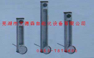

CYW£­76¡«500ϵÁÐҺλҺμÆ
£¨Ò»£©¼ò½é
CYW£­76¡«500ϵÁд«¸ÐʽҺλҺμÆÊÇÎÒ³§ÔÚÅúÁ¿Éú²úCYW£­76¡«500ϵÁеĻù´¡É¾£¬²Î¿¼¹úÍâÏȽø¼¼Êõ×ÊÁÏ¿ª·¢µÄÒ»ÖÖвúÆ·¡£
ËüÊÇÀûÓÃË«½ðÊôƬÈÈÕÍÀäËõÁéÃô¶ÈÏ൱¸ßµÄÌØµãÀ´²âÁ¿ÓÍÒºµÄζȡ£ÕâÑùÒDZí¾ßÓÐ׼ȷ¶È¸ß£¬¶ÁÊýÈÝÒ×£¬¼á¹ÌÄÍÕðµÈÌØµã£¬¿É¹ã·ºÓ¦ÓÃÓÚ¸÷ÖÖÓÍÏä¡¢Èó»¬×°Öá¢ÀäÈ´ºÍ³ÝÂÖ´«¶¯ÏäÖеÄҺλҺβâÁ¿¡£

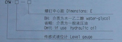

(Èý)ÐͺÅ˵Ã÷

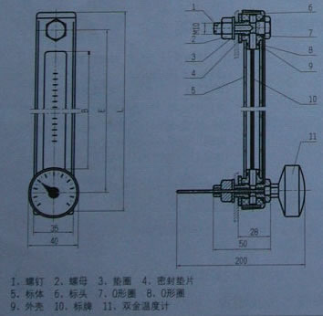

£¨Î壩°²×°ÓëʹÓÃ
1¡¢¸ù¾ÝÑ¡Óùæ¸ñµÄÖÐÐľà[E]³ß´ç£¬À´¼Ó¹¤¶þ¸ö°²×°¿×£¬ÀýÈçÓÍÏäµÄ±Úºñ¡Ü10mmʱ£¬¶þ¸ö°²×°Âݶ¤µÄ¹â¿×Ϊ¦Õ11mm£¬ÈôÓÍÏäµÄ±Úºñ>10mmʱ£¬¶þ¸ö°²×°Âݶ¤µÄÂÝÎÆ¿×ΪM10£¬È»ºó´¦ÀíÒÔÉÏÁ½ÖÖ¿×µÄÆ½Ã棬ÒÔ·ÀÖ¹°²×°ºóµÄ©Ó͵ÈÎÊÌâ¡£
2¡¢°²×°ºÃ±ê±¾ÒÔºó£¬ÔÙÅ¡ÉÏË«½ðÊôζȼƣ¬ÎðÒÔÐýת±íÍ·À´Å¡½ô£¬ÐëÔÚ±íÍ·ºóÃæÁù½Ç´¦ÓðâÊÖÅ¡½ô¡£
3¡¢ÎªÁ˱£Ö¤Î¶ȼƵÄ׼ȷÐÔ£¬´«¸Ð¹Ü½øÈë±»²â½éÖʵÄÉî¶ÈÓ¦·ûºÏ¡°´«¸Ð¹Ü²åÈë½éÖʳ¤¶È£º>90mm¡±µÄÒªÇó¡£
4¡¢Î¶ȼÆÔÚÔËÊ䣬±£¹Ü£¬°²×°ºÍʹÓùý³ÌÖУ¬Ó¦±ÜÃâÅöײ£¬Îðʹ´«¸Ð¹ÜÍäÇúºÍ±äÐΡ£
5¡¢Î¶ȼƾ­³£¹¤×÷µÄζÈÖµÔÚ×î´óÁ¿³ÌµÄ1/2¡«3/4´¦ÎªÒË¡£
6¡¢±¾²úÆ·±íÃæÇÐÎðÓëÏã½¶Ë®½Ó´¥¡£
