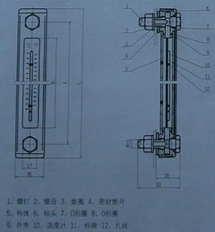

(¶þ)ÍâÐμ°°²×°³ß´ç£º
ÐͺÅ
³ß´ç(mm)
L
E
B
YWZ-76
106
76
37
YWZ-76T
106
76
37
YWZ-80
110
80
42
YWZ-80T
110
80
42
YWZ-100
130
100
62
YWZ-100T
130
100
62
YWZ-125
155
125
87
YWZ-125T
155
125
87
YWZ-127
157
127
89
YWZ-127T
157
127
89
YWZ-150
180
150
112
YWZ-150T
180
150
112
YWZ-160
190
160
122
YWZ-160T
190
160
122
YWZ-200
230
200
162
YWZ-200T
230
200
162
YWZ-250
280
250
212
YWZ-250T
280
250
212
YWZ-254
284
254
216
YWZ-254T
284
254
216
YWZ-300T
330
300
262
YWZ-350T
380
350
312
YWZ-400T
430
400
362
YWZ-450T
380
450
412
YWZ-500T
530
500
462

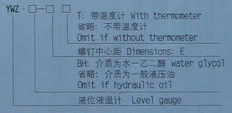

(Èý)ÐͺÅ˵Ã÷
