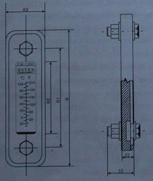

(¶þ)ÍâÐμ°°²×°³ß´ç£º
ÐͺÅ
³ß´ç(mm)
H
H1
H2
H3
CQ-80
128
80
46
43
CQ-80T
128
80
46
43
CQ-100
148
100
66
48
CQ-100T
148
100
66
48
CQ-120
168
120
86
48
CQ-120T
168
120
86
48
CQ-127
175
127
93
48
CQ-127T
175
127
93
48
CQ-150
198
150
116
48
CQ-150T
198
150
116
48
CQ-190
238
190
156
48
CQ-190T
238
190
156
48
CQ-250
298
250
216
48
CQ-250T
298
250
216
48

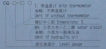

(Èý)ÐͺÅ˵Ã÷

(Îå)°²×°·½·¨¼°¸½½ü:
¸ù¾ÝÑ¡ÓÃҺλ¼ÆµÄ¹æ¸ñ£¨H1£©³ß´ç£¬°´ÒªÇóÔÚÓÍÏä²à°åÉϼӹ¤ºÃÁ½¸ö°²×°¿×£¬Á½¸ö°²×°¹â¿×Ϊ13mm£»°²×°¿×µÄÆ½ÃæÓ¦Æ½Ö±£¬ÒÔ·ÀÖ¹°²×°ºó©ÓÍ£¬ÔÚ°²×°ÒºÎ»¼ÆÂݶ¤Ê±£¬Å¡½ôÁ¦Ó¦ÊÊÖУ¬ÒÔÊʶÈÃܷⲻ©ÓÍΪÒË£¬±ÜÃâËð»µÒºÎ»¼Æ¡£ÒºÎ»¼Æ¸½¼þ£»ÂÝĸ¡¢µæÈ¦¡¢ÃÜ·âÆ½µæÈ¦¸÷Á½Ö»£¬¾ùÓÉÎÒ³§Ìṩ¡£

¸ù¾ÝÓÍÏäҺλÀ´Ñ¡Ôñ¹æ¸ñ£¬ÈôÐèÂÝ¿×ÖÐС¾àΪ150mmµÄ²»´øÎ¶ȼƵÄҺλ¼ÆÊ±£¬ÐͺÅΪCQ£­150£»ÈôÐè´øÎ¶ȼƣ¬ÔòÐͺÅΪCQ£­150T¡£
