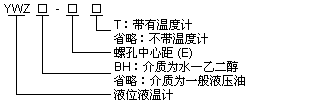

ÐͺÅ˵Ã÷

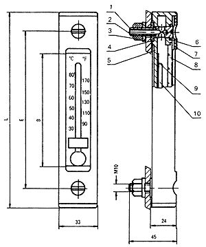

¼¼Êõ²ÎÊý
ÐͺÅ
³ß´çmm
L
E
B
YWZ-80
110
80
42
YWZ-80T
YWZ-100
130
100
60
YWZ-100T
YWZ-125
155
125
85
YWZ-125T
YWZ-127
157
127
87
YWZ-127T
YWZ-150
180
150
100
YWZ-150T
YWZ-160
190
160
120
YWZ-160T
YWZ-200
230
200
155
YWZ-200T
YWZ-250
280
250
200
YWZ-250T
YWZ-300T
330
300
250
YWZ-350T
380
350
300
YWZ-400T
430
400
350
YWZ-450T
480
450
400
YWZ-500T
530
500
450

¸ù¾ÝѡȡÓùæ¸ñµÄÖÐÐľàE³ß´ç£¬À´¼Ó¹¤ºÃ¶þÖ»°²×°¿×£¬ÀýÈçÓÍÏäµÄ±Úºñ¡Ü10mmʱ£¬Çë¼Ó¹¤ºÃ¶þÖ»°²×°Âݶ¤µÄ¹â¿×Ö±¾¶Îª11mm£¬ÈôÓÍÏäµÄ±Úºñ>10mmʱ£¬Çë¼Ó¹¤ºÃ¶þÖ»°²×°Âݿ׵ÄÂÝÎÆ¿×ΪM10£¬²¢´¦ÀíÒÔÉÏÁ½ÖÖ¿×µÄÆ½Ã棬ÒÔ·ÀÖ¹°²×°ºóµÄ©Ó͵ÈÎÊÌ⣬Һλ¼Æ¸½¼þ£ºÂÝĸ¡¢µæÈ¦¡¢ÃÜ·âÆ½µæÈ¦¸÷Á½Ö»£¬¾ùÓÉÎÒ³§Ìṩ¡£

¸ù¾ÝÓÍÏäҺλÀ´Ñ¡Ôñ¹æ¸ñ£¬ÈôÐèÂÝ¿×ÖÐÐľàΪ250mmµÄ²»´øÎ¶ȼƵÄҺλ¼Æ£¬Ôò±êΪYWZ250£¬ÈôÐè´øÎ¶ȼƣ¬Ôò±êΪYWZ-250T¡£
