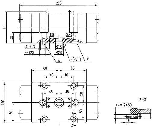

ÍâÐγߴç
×¢£ºFLB¡¢H-SÐÍϵÁзÖÁ÷·§£¬¼ÆÈý¸ö¹æ¸ñ£¬Í³Ò»ÎªÒ»¸ö°²×°³ß´ç
