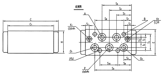

Ò»¡¢ÓÃ;
Òº¶¯·§ÊÇÓÿØÖÆÓÍ··¢³öµÄÒº¼ÇºÅʹ»¬·§Òƶ¯£¬À´ÊµÏÖÓÍ·µÄ»»Ïò£¬Ë³Ðò¶¯×÷µÈ¡£
Òº¶¯»¬·§·ÖΪ´ø×èÄáµÄ(63Éý/·Ö)ºÍ²»´ø×èÄáµÄ(25Éý/·ÖÒÔÏÂ)¶þÖÖ£¬´ø×èÄáµÄÒº¶¯»¬·§¿ÉÒÔµ÷½Ú×èÄáÂݶ¤¸Ä±äÆä»»Ïòʱ¼ä¡£
PΪ½øÓͿڣ¬OΪ»ØÓͿڣ¬A¡¢BÖÁÓ͸××óÓÒÇ»£¬KΪ¿ØÖÆÓͽø¿Ú£¬LΪйÓͿڡ£

Èý¡¢ÍâÐγߴç
¹Üʽ
·²ÊôÁ½Î»ÕßΪL
ÐͺÅ
³ß´ç ºÁÃ×
°²×°Âݶ¤
C
E
H
C
1
E
1
H
1
S
1
S
2
S
3
S
4
S
5
S
6
S
7
T
T
1
G
1
G
2
k
1
k
2
J
24Y-63Z
246
112
76
142
66
15
39
61
83
106
20
102
115
88
66
35
64
Z
1/8
Z
3/4
M10X25
34Y-63Z
(H.Y.P.M)

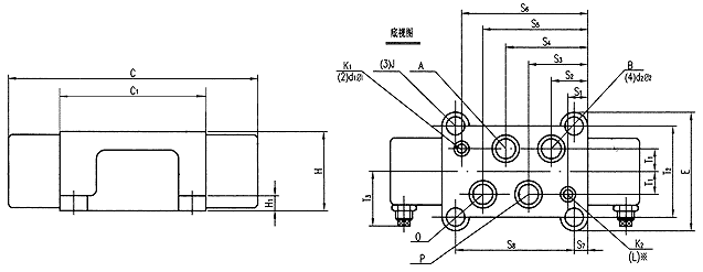

·²ÊôÁ½Î»ÕßΪL
ÐͺÅ
³ß´ç ºÁÃ×
°²×°Âݶ¤
C
E
H
C
1
S
1
S
2
S
3
S
4
S
5
S
6
S
7
S
8
S
9
S
10
T
1
T
2
T
3
d
1
¦µ
1
d
2
¦µ
2
J
24Y-10B
109
55
47
90
8.5
19
32
45
58
71
19
52
29
32
8
11
40
¦µ
5
¦µ
12
¦µ
8
¦µ
16
M6X30
25Y-10B
34Y-10B
(H.Y.J.K.P.C)
35Y-10B
(H.Y.J.K.P.C)
24Y-25B
128
60
54
108
9
23
38.5
54
69.5
85
23
62
38.5
31
9
13.5
42
¦µ
12
¦µ
20
M8X30
25Y-25B
34Y-25B
(H.Y.J.K.P.C)
35Y-25B
(H.Y.J.K.P.C)

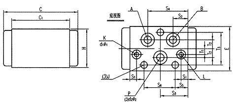

·²ÊôÁ½Î»ÕßΪL
ÐͺÅ
³ß´ç ºÁÃ×
°²×°Âݶ¤
C
E
H
C
1
H
1
S
1
S
2
S
3
S
4
S
5
S
6
S
7
S
8
T
1
T
2
T
3
d
1
¦µ
1
d
2
¦µ
2
J
24Y-63BZ
242
112
76
142
15
20
39
61
83
106
122
13.5
115
24
88
66
¦µ
6
¦µ
12
¦µ
18
¦µ
28
M10X25
34Y-63BZ (H.Y.P.M)
