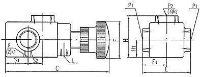

Ò»¡¢ÓÃ;
˳Ðò·§Ö±½ÓÀûÓýø¿ÚÓÍ·±¾ÉíµÄѹÁ¦À´¿ØÖÆÒºÑ¹ÏµÍ³Öи÷ҺѹԪ¼þ¶¯×÷µÄÏȺó˳Ðò£¬ÒÔʵÏÖϵͳµÄ×Ô¶¯¿ØÖÆ¡£
P1Ϊ½øÓͿڣ¬P2Ϊ³öÓͿڣ¬LΪйÓÍ¿Ú(LÓ¦µ¥¶À½Ó»ØÓÍÏä)
¶þ¡¢Ö÷Òª¼¼Êõ²ÎÊý
ÐͺÅ
Á÷Á¿
L/min
ѹÁ¦ MPa
ÖØÁ¿ kg
¹Üʽ
°åʽ
X-25
X-25B
25
0.5¡«6.3
2.1
X-63
X-63B
63
3
Èý¡¢ÍâÐγߴç
¹Üʽ
ÐͺÅ
³ß´ç ºÁÃ×
C×î´ó
C×îС
E
H
S
1
S
2
E
1
H
1
K
1
K
2
F
X-25
144.5
140
60
55
29
18
30
25
Z
1/8
Z
3/8
¦µ42
X-63
155.5
151
74
64
34
22
37
27
Z
3/4
°åʽ
×¢£º°åʽ˳Ðò·§ÍâÐγߴçͬÁ÷Á¿°åʽ¼õѹ·§Ïàͬ¡£Ë³Ðò·§X-25,˳Ðò·§X-63
