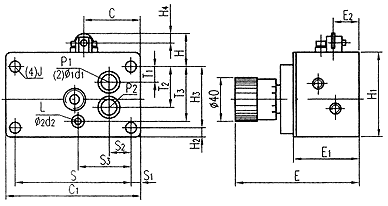

| µ¥ÏòÐг̵÷ËÙ·§ |
Ò»¡¢ÓÃ; |
µ¥ÏòÐг̵÷ËÙ·§Êǵ¥Ïò·§ºÍÐг̵÷ËÙ·§µÄ×éºÏ£¬ËüÄÜÂú×ã»ú´²ÒºÑ¹ÏµÍ³¿ì½ø¡¢Âý½ø¡¢¿ìÍ˵ÄÐèÒª£¬Óëµ¥ÏòÐг̽ÚÁ÷·§ÏàËÆ£¬µ«ÆäËÙ¶È¿ØÖÆÊÇ¿¿µ÷½Ú½ÚÁ÷·§£¬¶ø²»¿¿×²¿é£¬´Ë·§Óëµ÷ËÙ·§Ò»Ñù£¬²»ÊܸºÔر仯µÄÓ°Ïì¡£ P1Ϊ½øÓͿڣ¬P2Ϊ³öÓͿڣ¬LΪйÓͿڡ£ | |
¶þ¡¢Ö÷Òª¼¼Êõ²ÎÊý |
| ÐͺŠ|
Á÷Á¿ L/min |
¹¤×÷ѹÁ¦ MPa |
ѹÁ¦Ëðʧ MPa |
·´ÏòѹÁ¦Ëðʧ Mpa |
ÖØÁ¿ kg |
| ×î´ó |
×îС |
| QCI1-25B |
25 |
0.07 |
0.5¡«6.3 |
0.2 |
0.25 |
5.4 | |
Èý¡¢ÍâÐγߴç |
| ÐͺŠ|
³ß´ç ºÁÃ× |
| E |
C |
C1 |
S |
S1 |
S2 |
S3 |
H |
H1 |
H2 |
H3 |
H4 |
T1 |
T2 |
T3 |
E1 |
E2 |
d1 |
¦µ1 |
d2 |
¦µ2 |
J |
| QCI1-25B |
114¡«123 |
51 |
125 |
110 |
7.5 |
28.5 |
58.5 |
28.5 |
79 |
7.5 |
60 |
6 |
16 |
39.5 |
52.5 |
60 |
23 |
¦µ12 |
¦µ20 |
¦µ5 |
¦µ10 |
M6X60 | | |
