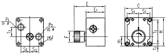

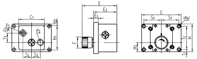

Èý¡¢ÍâÐγߴç
¹Üʽ
ÐͺÅ
³ß´ç ºÁÃ×
C
E
H
C
1
E
1
E
2
H
1
H
2
H
3
S
1
S
2
S
3
T
1
T
2
T
3
K
J
F
Q-10
124
116¡«125
90
82
14
76
80
5
29
53
23
23
9
72
34
Z
1/4
M6
40
Q-25
130
118¡«129
95
88
14
78
85
5
30
56
23
23
9
77
32
Z
3/8
M6
Q-63
136
139¡«148
110
100
14
99
100
5
33
60
25
30
8
94
37
Z
3/4
M6
°åʽ
ÐͺÅ
³ß´ç ºÁÃ×
C
E
H
H
1
E
1
S
1
S
2
S
3
T
1
T
2
T
3
d
1
d
2
¦µ
J
F
Q-10B
82
115¡«124
90
28
75
31
23
26
10
70
27
¦µ8
¦µ8
¦µ16
M8X60
40
Q-25B
88
118¡«127
95
30
78
34
23
26
10
75
27
¦µ12
¦µ12
¦µ22
M8X70
Q-63B
100
139¡«148
110
33
99
40
25
31
10
90
37
¦µ16
¦µ16
¦µ28
M8X80
