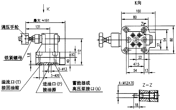

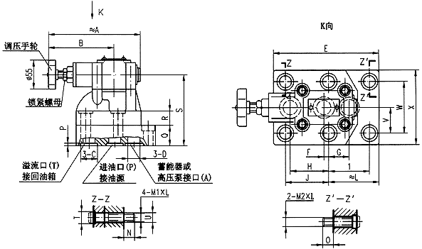

ÍâÐγߴç
°åʽÁ¬½Ó (HY-H¡ù10ÐÍ)
(HY-H¡ù20ÐÍ, HY-H¡ù32ÐÍ)
ÐͺÅ
¹«³ÆÍ¨¾¶
mm
³ß´ç
mm
A
B
C
D
E
F
G
H
I
J
L
M
1
XL
M
2
XL
N
O
P
Q
R
S
T
U
V
W
Y
HY-H¡ù20
20
201
127
¦µ32
¦µ20
146
11.1
31
55.6
47
66.7
63
M16X95
M16X55
24
22
2.4
47
25
132
¦µ26
¦µ17
34.9
69.8
100
HY-H¡ù32
32
212
123
¦µ40
¦µ28
183
12.7
38
76.2
55
88.9
76
M20X110
M20X70
27
27
2.4
55
30
145
¦µ33
¦µ22
41.3
82.6
120
