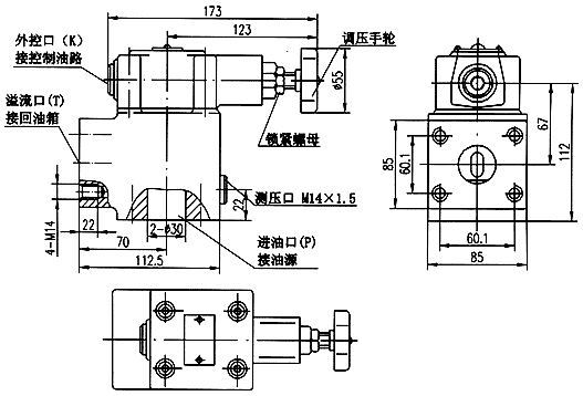

Y2¡¢YFÐÍÒçÁ÷·§ÓÃ;
ÒçÁ÷·§ÊÇѹÁ¦¿ØÖÆÔª¼þ£¬Ö÷Òª¹¦ÄÜÊÇά³ÖҺѹϵͳµÄѹÁ¦ºã¶¨»ò·ÀֹϵͳѹÁ¦³¬ÔØ£¬Æð°²È«·§×÷Óá£YF-SºÍY2ÐÍÒçÁ÷·§¹¤×÷¿É¿¿£¬ÐÔÄÜÎȶ¨ÇÒ¾ßÓÐÌå»ýС¡¢ÖØÁ¿ÇᡢάÐÞ·½±ãºÍ¸ßѹµÍÔëÉùµÈÌØµã¡£
¼¼Êõ¹æ¸ñ
ÐͺÅ
ѹÁ¦µ÷½Ú·¶Î§
MPa
¹«³ÆÍ¨¾¶
mm
¹«³ÆÁ÷Á¿
L/min
¶î¶¨Á÷Á¿
L/min
Y
2
-H¡ù10L
YF-L/B10H¡ù-S
¡¡H
a: 0.6¡«8.0
¡¡ b: 4.0¡«16
¡¡ c: 8.0¡«20
¡¡ d: 16¡«31.5
¡¡H
1: 0.6¡«8.0
¡¡ 2: 4.0¡«16
¡¡ 3: 8.0¡«20
¡¡ 4: 16¡«31.5
10
63
40
Y
2
-H¡ù20L
YF-L/B20H¡ù-S
20
200
160
100
Y
2
-H¡ù32L
YF-L/B32H¡ù-S
32
400
320
200

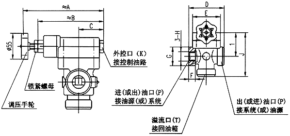

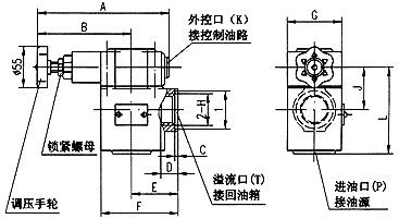

ÍâÐγߴç
¹Üʽ (Y
2
-H¡ù¡ùLÐÍ)
ÐͺÅ
¹«³ÆÍ¨¾¶
mm
³ß´ç
mm
A
B
C
D
E
F
G
H
I
J
L
Y
2
-H¡ù10L
10
173
131
1
16
33
63
M22X1.5
31
44
89
Y
2
-H¡ù20L
20
173
127
1
19
54
93
62
M33X2
44
104
Y
2
-H¡ù32L
32
173
123
1
23
65
107
84
M48X2
61
62
122

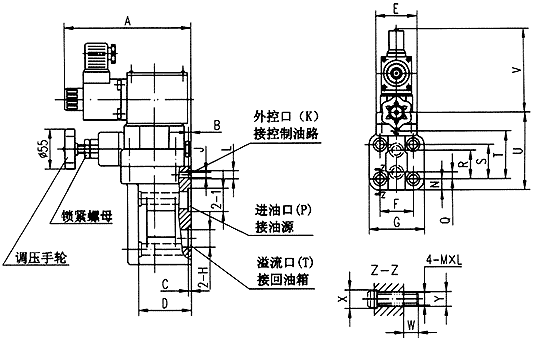

°åʽ (Y
2
-H¡ù¡ùÐÍ)
ÐͺÅ
¹«³ÆÍ¨¾¶
mm
³ß´ç
mm
A
B
C
D
E
F
G
H
I
J
L
MXL
N
O
P
Q
R
S
T
U
V
W
X
Y
2
-H¡ù10
10
173
131
22
13
4
10
18
80
22
47.5
M12X30
13
54
1.8
1.4
25
72
20
13
27
54
80
Y
2
-H¡ù20
20
173
127
32
20
4
10
21
117
11.1
23.8
55.6
M16X45
34
66.7
2.4
1.4
25
85
26
17
34.9
69.8
100
Y
2
-H¡ù32
32
173
123
40
28
4
10
27
150
12.7
31.8
76.2
M20X55
43
88.9
2.4
1.4
30
90
33
22
41.3
82.6
120

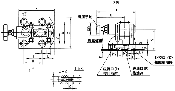

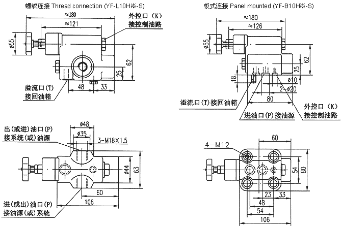

·¨À¼ (Y
2
-H¡ù32FÐÍ)
ÂÝÎÆÁ¬½Ó (YF-L¡ùH¡ù-SÐÍ)
ÐͺÅ
¹«³ÆÍ¨¾¶
mm
³ß´ç
mm
A
B
C
D
E
F
G
H
I
J
YF-L20H¡ù-S
20
161
128
48
100
78
18
¦µ50
M27X2
67
117
YF-L32H¡ù-S
32
165
132
51
125
84
23
¦µ70
M42X2
84
149

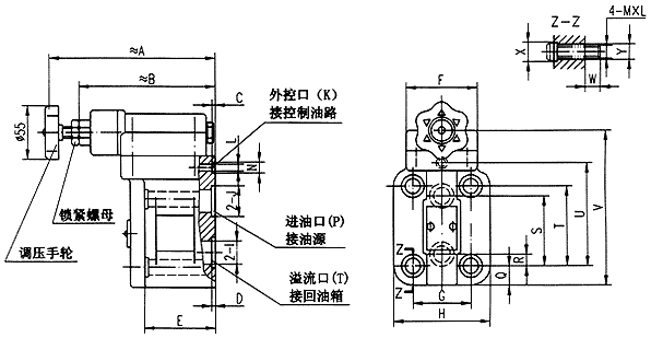

°åʽÁ¬½Ó (YF-B¡ùH¡ù-SÐÍ)
ÐͺÅ
¹«³ÆÍ¨¾¶
mm
³ß´ç
mm
A
B
C
D
E
F
G
H
I
J
L
MXL
N
Q
R
S
T
U
V
W
X
Y
YF-B20H¡ù-S
20
163
130
1.4
2.4
68
78
70
100
¦µ21
¦µ30
¦µ4
M16X85
¦µ10
15
13
58
66
93
140
20
¦µ26
¦µ17
YF-B32H¡ù-S
32
167
134
1.4
2.4
73
84
82
118
¦µ28
¦µ40
¦µ4
M20X100
¦µ10
21
12
77
89
122
182
28
¦µ31.5
¦µ21.5

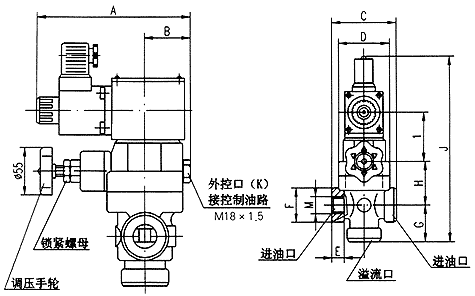

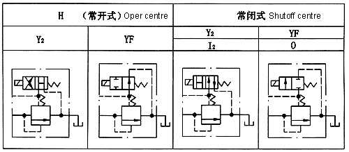

Y2¡¡¢YF¡Ð͵ç´ÅÒçÁ÷·§
ÓÃ;
µç´ÅÒçÁ÷·§ÓÉÒçÁ÷·§ºÍµç´Å»»Ïò·§×é³É¡£¸ù¾ÝÓÃ;²»Í¬¿É·ÖHÐÍ(³£¿ªÊ½)ºÍI2ÐÍ¡¢OÐÍ(³£±Õʽ)¶þÖÖ¡£Ê¹Óõçѹ·ÖΪ½»Á÷50Hz¡¢220V¼°Ö±Á÷24VµÈ¡£µç´ÅÒçÁ÷·§²»½ö½á¹¹½ô´Õ¡¢¿Õ¼äλÖÃС£¬¶øÇÒÄܸÄÉÆÏµÍ³ºÍ»ØÂ·µÄÐÔÄÜ£¬¿¹ÕñºÍ³å»÷ÐÔÄܺ㬲¢ÇҿɼõÉٹܷµÄÕñ¶¯ÏÖÏó¡£

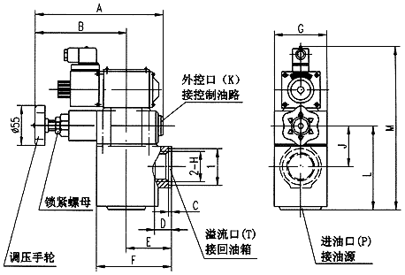

ͼÐηûºÅ
ÍâÐγߴç
°åʽ (YF¡ù¡ù-B¡ùH¡ù-SÐÍ)
ÐͺÅ
¹«³ÆÍ¨¾¶
mm
³ß´ç
mm
A
B
C
D
E
F
G
H
I
J
L
MXL
N
Q
R
S
T
U
V
W
X
Y
YF¡ù¡ù-B20H¡ù-S
20
167
1.4
2.4
66
78
70
100
21
30
4
10
M16X85
15
13
58
66
93
140
133
22
25
17
YF¡ù¡ù-B32H¡ù-S
32
169
1.4
2.4
70
84
82
118
28
40
4
10
M20X100
21
12
77
89
122
182
134
31
31.5
21.5
¹Üʽ (YF¡ù¡ù-L¡ùH¡ù-SÐÍ)
ÐͺÅ
¹«³ÆÍ¨¾¶
mm
³ß´ç
mm
A
B
C
D
E
F
G
H
I
J
M
YF¡ù¡ù-L20H¡ù-S
20
165
48
100
70
18
67
60
250
M27X2
YF¡ù¡ù-L32H¡ù-S
32
167
51
125
84
23
70
65
84
61
283
M42X2

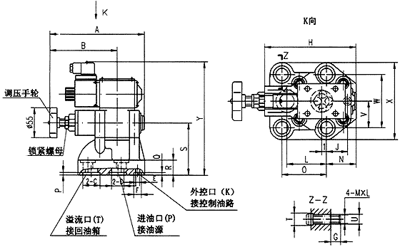

°åʽ (Y
2
¡ù¡ù-H¡ù¡ùÐÍ)
ÐͺÅ
¹«³ÆÍ¨¾¶
mm
³ß´ç
mm
A
B
C
D
E
F
G
H
I
J
L
MXL
N
O
P
Q
R
S
T
U
V
W
X
Y
Y2¡ù¡ù-H10
10
173
131
22
13
4
10
18
80
22
0
47.5
M12X30
13
54
1.8
1.4
25
72
20
13
27
54
80
178
Y2¡ù¡ù-H20
20
173
127
32
20
4
10
21
117
11.1
23.8
55.6
M16X35
34
66.7
2.4
1.4
25
85
26
17
34.9
69.8
100
191
Y2¡ù¡ù-H32
32
173
125
40
28
4
10
27
150
12.7
31.8
76.2
M20X55
43
88.9
2.4
1.4
30
90
33
22
41.3
82.6
120
196
