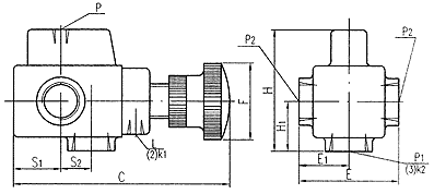

Ò»¡¢ÓÃ;
µ¥Ïò¼õѹ·§Óɵ¥Ïò·§ºÍ¼õѹ·§²¢Áª×é³É£¬Æä×÷ÓÃÓë¼õѹ·§Ïàͬ£¬ÒºÁ÷ÕýÏòͨ¹ýʱ£¬µ¥Ïò·§¹Ø±Õ£¬¼õѹ·§¹¤×÷¡£µ±ÒºÁ÷·´Ïòͨ¹ýʱ£¬µ¥Ïò·§¿ªÆô£¬¼õѹ·§²»¹¤×÷¡£
P1Ϊ½øÓͿڣ¬P2Ϊ³öÓͿڣ¬LΪйÓÍ¿Ú(LÓ¦µ¥¶À½Ó»ØÓÍÏä)
¶þ¡¢Ö÷Òª¼¼Êõ²ÎÊý
ÐͺÅ
Á÷Á¿
L/min
ѹÁ¦µ÷Õû·¶Î§ MPa
ÖØÁ¿ (kg
¹Üʽ
°åʽ
JI-10
JI-10B
10
0.5¡«5
2
JI-25
JI-25B
25
2.5
JI-63
JI-63B
63
Èý¡¢ÍâÐγߴç
¹Üʽ
ÐͺÅ
³ß´ç ºÁÃ×
C×î´ó
C×îС
E
H
S
1
S
2
E
1
H
1
K
1
K
2
F
JI-10
134.5
130
54
61
27
14
27
Z
1/8
Z
1/4
¦µ42
JI-25
144.5
140
60
75
29
18
30
Z
3/8
JI-63
155.5
151
74
90
34
22
37
Z
3/4

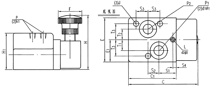

°åʽ
ÐͺÅ
³ß´ç ºÁÃ×
C
E
H
×î´ó
H
×îС
C
1
E
1
H
1
S
1
S
2
S
3
S
4
T
1
T
2
T
3
d
1
¦µ
1
d
2
¦µ
2
k
1
J
F
JI-10B
107
58
97.5
93
65
29
58
24
14
17
¦µ7
11
19
¦µ
8
¦µ
16
¦µ
4
¦µ
8
Z
1/8
M8X50
¦µ
42
JI-25B
117
66
103.5
99
75
33
65
28
18
19
13
23
¦µ
12
¦µ
22
M8X40
JI-63B
128
82
106.5
102
86
41
82
30
22
22
19
29
¦µ
18
¦µ
30
M8X45
