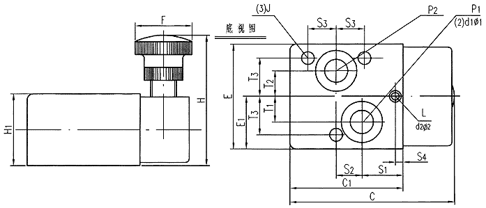

Ò»¡¢ÓÃ;
¼õѹ·§ÊÇÒ»Öֿɽ«½Ï¸ßµÄ½ø¿ÚѹÁ¦½µµÍΪËùÐèµÄ³ö¿ÚѹÁ¦µÄѹÁ¦µ÷½Ú·§¡£
P1Ϊ½ø¿Ú£¬P2Ϊ³ö¿Ú£¬LΪ¼ÓÓÍ¿Ú(Ó¦µ¥¶À½ÓÓÍÏä)¡£¹Üʽ¼õѹ·§ÓÐÒ»Ô¶³Ìµ÷ѹ¿Ú(ÒÔK±íʾ)¡£
¶þ¡¢Ö÷Òª¼¼Êõ²ÎÊý
ÐͺÅ
Model
Á÷Á¿
L/min
ѹÁ¦µ÷Õû·¶Î§ MPa
ÖØÁ¿ kg
¹Üʽ
°åʽ
J-10
J-10B
10
0.5¡«5
1.6
J-25
J-25B
25
2.1
J-63
J-63B
63
3
Èý¡¢ÍâÐγߴç
¹Üʽ
ÐͺÅ
³ß´ç ºÁÃ×
C×î´ó
C×îС
E
H
S
1
S
2
E
1
H
1
K
1
K
2
F
J-10
134.5
130
54
49
27
14
27
22
Z
1/8
Z
1/4
¦µ42
J-25
144.5
140
60
55
29
18
30
25
Z
3/8
J-63
155.5
151
74
64
34
22
37
27
Z
3/4
°åʽ
ÐͺÅ
³ß´ç ºÁÃ×
C
E
H
×î´ó
H
×îС
C
1
E
1
H
1
S
1
S
2
S
3
S
4
T
1
T
2
T
3
d
1
¦µ
1
d
2
¦µ
2
J
F
J-10B
107
58
97.5
93
65
29
46
24
14
17
7
11
19
¦µ
8
¦µ
16
¦µ
4
¦µ
8
M8X50
¦µ
42
J-25B
117
66
103.5
99
75
33
52
28
18
19
13
23
¦µ
12
¦µ
22
M8X40
J-63B
128
82
106.5
102
86
41
56
30
22
22
19
29
¦µ
18
¦µ
30
M8X45
