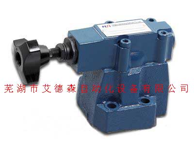

DRÐÍ30/5XϵÁÐÏȵ¼Ê½¼õѹ·§
DRÐͼõѹ·§ÊÇÏȵ¼¿ØÖƵļõѹ·§£¬ÓÃÓÚ½µµÍϵͳÖÐijһ»ØÂ·µÄѹÁ¦ºÍÐèҪƽÎÈÓÍÔ´µÄ»ØÂ·¡£ 5XϵÁÐDRÐÍ·§Óë30ϵÁÐDRÐÍ·§¶¼¾ßÓÐÏàͬµÄÁ¬½Ó·½Ê½£¬ÏàͬµÄѹÁ¦µ÷½ÚÐÎʽ¡£5XϵÁÐDRÐÍ·§ÐÔÄÜÓÅÓÚ30ÐÍDR·§£¬Æä¾ßÓиüƽÎȵĵ÷ѹÐÔÄÜ£¬ÔÚ´óÁ÷Á¿Çé¿öÏÂÓнϵ͵ÄÊä³öѹÁ¦£¬Í¨Á÷ÄÜÁ¦ºÍµ÷ѹ·¶Î§´óµÄÌØµã¡£

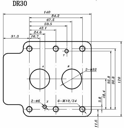

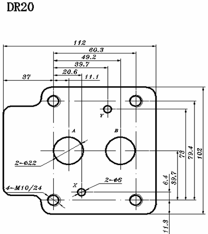

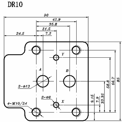

ͨ¾¶ |
¹Üʽ |
ͨ¾¶ |
¹«ÖÆ |
Ó¢ÖÆ |
8 |
M18x1.5 |
G3/8" |
10 |
10 |
10 |
M22x1.5 |
G1/2" |
16 |
M27x2 |
G3/4" |
20 |
20 |
20 |
M33X2 |
G1" |
25 |
M42x2 |
G1 1 /4" |
32 |
30 |
30 |
M48x2 |
G11 /2" |
