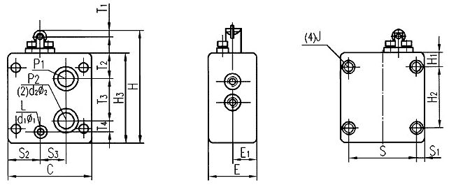

µ¥ÏòÐг̽ÚÁ÷·§
Ò»¡¢ÓÃ;
µ¥ÏòÐг̽ÚÁ÷·§Êǵ¥Ïò·§ºÍÐг̽ÚÁ÷·§µÄ×éºÏ£¬Ëü¿ÉÒÔÂú×ã»ú´²Òº½ø¸øÏµÍ³¿ì½ø¡¢Âý½øºÍ¿ìÍ˵ÄÐèÒª¡£ÆäÂý½øÊÇ¿¿×²¿é»ò͹ÂÖÀ´¿ØÖÆ¡£Éè¼Æ²»Í¬µÄײ¿é»ò͹ÂÖºóÒ²¿ÉÒÔÓÃÓÚÐèÒª¼¸ÖÖÂýËÙ½ø¸øµÄµØ·½¡£
P1½øÓͿڣ¬P2Ϊ³öÓͿڣ¬LΪйÓͿڡ£
¶þ¡¢Ö÷Òª¼¼Êõ²ÎÊý
ÐͺŠÁ÷Á¿ L/min ¹¤×÷ѹÁ¦ MPa ѹÁ¦Ëðʧ MPa ·´ÏòѹÁ¦Ëðʧ Mpa ÖØÁ¿ kg
¹Üʽ °åʽ ×î´ó ×îС
LCI1-25 LCI1-25B 25 0.07 0.3¡«6.3 0.3 0.25 3
LCI1-63 LCI1-63B 63 0.1 3.5
Èý¡¢ÍâÐγߴç
¹Üʽ
ÐͺŠ³ß´ç ºÁÃ×
C E E1 H H1 H2 H3 H4 T T1 T2 T3 S S1 k q J
LCI1-25 90 46 23 119 19 55 48 94 32 44 51 9 72 10 Z3/8" Z1/8" M8X50
LCI1-63 98 46 23 135 22 70 59 110 38 55 63 9 78 10 Z3/4" Z1/8" M8X50
°åʽ
ÐͺŠ³ß´ç ºÁÃ×
C E E1 H H1 H2 H3 T1 T2 T3 T4 S S1 S2 S3 d1 ¦µ2 d2 ¦µ2 J
LCI1-25B 90 46 23 119 19 55 94 9 30 38 12 70 10 26 37 ¦µ4 ¦µ12 ¦µ12 ¦µ20 M8X50
LCI1-63B 98 46 23 135 22 70 110 9 32 50 14 78 10 31 36 ¦µ4 ¦µ12 ¦µ18 ¦µ28 M8X50
