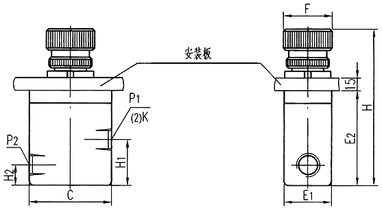

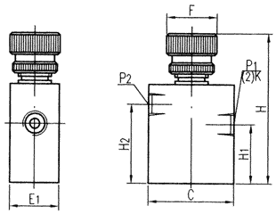

¹Üʽ
ÐͺŠ³ß´ç ºÁÃ×
C E1 H×î´ó Max H1 H2 K F
LI-10 50 27.7 89 36 48 Z1/4" ¦µ30
LI-25 68 27.7 106 43 59 Z3/8"
ÐͺŠ³ß´ç ºÁÃ×
C E1 H H1 H2 E2 K F
LI-63 100 52 150 58 25 97 Z3/4" ¦µ40
LI-100 110 70 174 67 28 118 Z1"

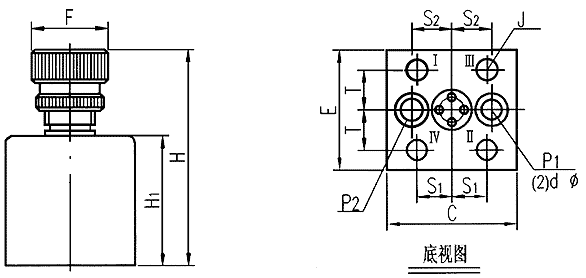

°åʽ
ÐͺŠ³ß´ç ºÁÃ×
C E H1 H S1 T S2 d ¦µ J J F
LI-10B 52 48 53 83 14 14 16 ¦µ8 ¦µ12 III IV M8X50 ¦µ30
LI-25B 64 54 60 96 17 17 20 ¦µ12 ¦µ16 I II M8X60
LI-63B 100 65 97 121 40 22.5 30 ¦µ18 ¦µ28 I II III IV M8X80 ¦µ40
LI-100B 124 70 118 154 52 25 38 ¦µ22 ¦µ32 I II III IV M10X120
