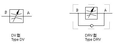

DVÐͽÚÁ÷·§ºÍDRVÐ͵¥Ïò½ÚÁ÷·§ÊÇÒ»ÖֱȽϼòµ¥¶øÓÖ¾«È·µØµ÷½ÚÖ´ÐÐÔª¼þËٶȵÄÁ÷Á¿¿ØÖÆ·§£¬ÍêÈ«¹Ø±ÕʱËüÓÖÊǽØÖ¹·§¡£ÐýŦÉϵIJÊÉ«¿Ì¶È±êÓÃÀ´ÏÔʾÁ÷Á¿µ÷½ÚµÄ´óС£¬²ÊÉ«Èý½ÇµÄ¿ª¶ÈÔ½´ó£¬Á÷Á¿Ô½´ó¡£Í¬Ê±ÔÚÖØÐµ÷½ÚʱÈÔÈ»¿ÉÒÔ¸ù¾Ý¿Ì¶È»Ö¸´µ½Ô­À´É趨µ÷½ÚµÄλÖÃÉÏ¡£
ͼÐÍ·ûºÅ

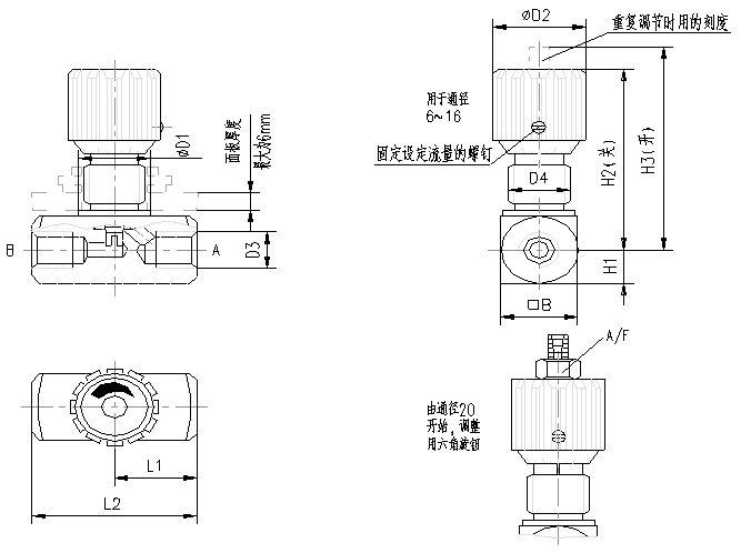

ÍâÐγߴç
1. DV/DRVÍâÐγߴç
¹æ¸ñ ¡õB ¦µD1 ¦µD2 D3 D4 H1 H2 H3 L1 L2 AF
DV DRV DV DRV
6 15 16 24 G1/8 M10X1 M12X1.25 8 50 55 19 26 38 45
8 25 19 29 G1/4 M14X1.5 M18X1.5 12.5 65 72 24 33.5 48 45
10 30 19 29 G3/8 M18X1.5 M18X1.5 15 67 74 29 41 58 65
12 35 23 38 G1/2 M22X1.5 M22X1.5 17.5 82 92 34 44 68 73<, /TD>
16 45 23 38 G3/4 M27X2 M22X1.5 22.5 96 100 39 57 78 88
20 50 38 49 G1 M33X2 M33X1.5 25 128 145 54 77 108 127 19
25 60 38 49 G11/4 M42X2 M33X1.5 30 133 150 54 93 108 143 19
30 70 38 49 G11/2 M48X2 M33X1.5 35 138 155 54 108 108 143 19
40 90 38 49 G2   M33X1.5 45 148 165   130   165 19

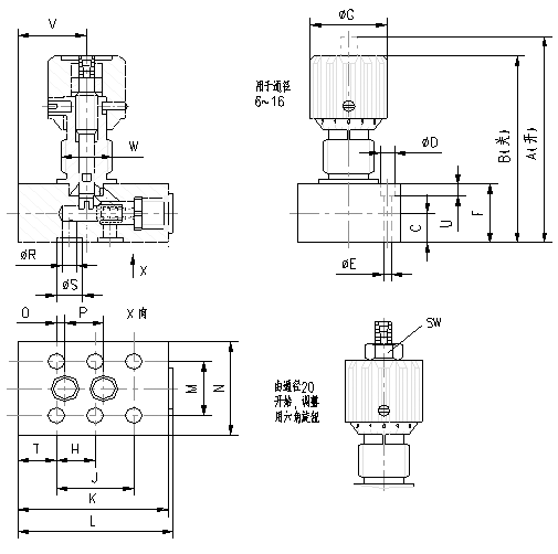

2.DRVPÍâÐγߴç
¹æ¸ñ A B C D E F G H J K L M
DRVP-6 63 58 8 11 6.6 16 24 - 19 41.5 43 28.5
DRVP-8 79 72 10 11 6.6 20 29 - 35 63.5 65 33.5
DRVP-10 84 77 12.5 11 6.6 25 29 - 33.5 70 72 38
DRVP-12 106 96 16 11 6.6 32 38 - 38 80 84 44.5
DRVP-16 128 118 22.5 14 9 45 38 38 76 104 107 54
DRVP-20 170 153 25 14 9 50 49 47.5 95 127 131 60
DRVP-25 175 150 27.5 18 11 55 49 60 120 165 169 76
DRVP-30 195 170 37.5 20 14 75 49 71.5 143 186 190 92
DRVP-40 220 203 50 20 14 100 49 67 133.5 192 196 111
¹æ¸ñ N O P R S T U V W SW ÖØÁ¿ (Kg)
DRVP-6 41.5 1.6 16 5 9.8 6.4 7 13.5 M12X1.25 - 0.26
DRVP-8 46 4.5 25.5 7 12.7 14.2 7 31 M18X1.5 - 0.50
DRVP-10 51 4 25.5 10 15.7 18 7 29.5 M18X1.5 - 0.80
DRVP-12 57.5 4 30 13 18.7 21 7 36.5 M22X1.5 - 1.10
DRVP-16 70 11.4 54 17 24.5 14 9 49 M22X1.5 - 2.50
DRVP-20 76.5 19 57 22 30.5 16 9 49 M33X1.5 19 3.90
DRVP-25 100 20.6 79.5 28.5 37.5 15 11 77 M33X1.5 19 6.70
DRVP-30 115 23.8 95 35 43.5 15 13 85 M33X1.5 19 11.0
DRVP-40 140 25.5 89 47.5 57.5 16 13 64 M33X1.5 19 17.5
×¢£ºDVPÓëDRVPÐͰ²×°Á¬½Ó³ß´çÒ»ÖÂ
