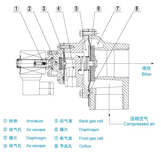

¹¤×÷Ô­Àí
¡¡¡¡Ä¤Æ¬°Ñµç´ÅÂö³å·§·Ö³Éǰ¡¢ºó¶þ¸öÆøÊÒ£¬µ±½ÓͨѹËõ¿ÕÆøÊ±£¬Ñ¹Ëõ¿ÕÆøÍ¨¹ý½ÚÁ÷¿×½øÈëºóÆøÊÒ£¬´ËʱºóÆøÊÒѹÁ¦½«Ä¤Æ¬×é¼þ½ôÌù·§µÄÊä³ö¿Ú£¬µç´ÅÂö³å·§´¦ÓÚ¡°¹Ø±Õ¡±×´Ì¬¡£
¡¡¡¡ Âö³åÅç´µ¿ØÖÆÒǵĵçÐźÅʹµç´ÅÂö³å·§ÏÎÌúºóÒÆ£¬·§ºóÆøÊÒ·ÅÆø¿×´ò¿ª£¬ºóÆøÊÒѸËÙʧѹ£¬Ä¤Æ¬×é¼þºóÒÆ£¬Ñ¹Ëõ¿ÕÆøÍ¨¹ý·§Êä³ö¿ÚÅç´µ£¬µç´ÅÂö³å·§´¦ÓÚ¡°¿ªÆô¡±×´Ì¬¡£
¡¡¡¡ Âö³åÅç´µ¿ØÖÆÒǵçÐźÅÏûʧ£¬µç´ÅÂö³å·§ÏÎÌú¸´Î»£¬ºóÆøÊÒ·ÅÆø¿×¹Ø±Õ£¬ºóÆøÊÒѹÁ¦Éý¸ßʹĤƬ×é¼þ½ôÌù·§µÄÊä³ö¿Ú£¬µç´ÅÂö³å·§ÓÖ´¦ÓÚ¡°¹Ø±Õ¡±×´Ì¬¡£
  ͼ1 ÄÚ²¿½á¹¹Í¼

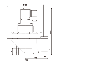

DMF-Z-50S
