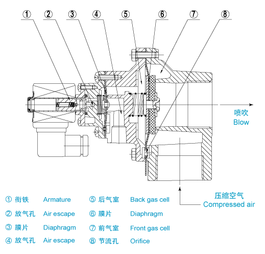

     µç´ÅÂö³å·§£¨Òà³Æ¸ôĤ·§£©ÊÇÂö³å´üʽ³ý³¾Æ÷Çå»ÒÅ紵ϵͳµÄѹËõ¿ÕÆø¡°¿ª¹Ø¡±¡£ÊÜÂö³åÅç´µ¿ØÖÆÒÇÊä³öÐźŵĿØÖÆ£¬¶ÔÂË´üÖðÅÅ£¨ÊÒ£©Åç´µÇå»Ò£¬Ê¹³ý³¾Æ÷µÄ×èÁ¦±£³ÖÔÚÉ趨µÄ·¶Î§Ö®ÄÚ£¬ÒÔ±£Ö¤³ý³¾Æ÷µÄ´¦ÀíÄÜÁ¦ºÍÊÕ³¾Ð§ÂÊ¡£
¡¡ DMF-ZÐ͵ç´ÅÂö³å·§ÎªÖ±½Çʽ·§£¬Æä½ø³ö¿ÚÖ®¼ä¼Ð½ÇΪ90o£¬ÊʺÏÓÚÆø°üÓë³ý³¾Æ÷Åç´µ¹ÜµÄ°²×°Á¬½Ó¡£ÆøÁ÷³©Í¨£¬ÄÜÌṩ·ûºÏÒªÇóµÄÇå»ÒÆøÂö³å¡£
¹¤×÷Ô­Àí
¡¡¡¡Ä¤Æ¬°Ñµç´ÅÂö³å·§·Ö³Éǰ¡¢ºó¶þ¸öÆøÊÒ£¬µ±½ÓͨѹËõ¿ÕÆøÊ±£¬Ñ¹Ëõ¿ÕÆøÍ¨¹ý½ÚÁ÷¿×½øÈëºóÆøÊÒ£¬´ËʱºóÆøÊÒѹÁ¦½«Ä¤Æ¬×é¼þ½ôÌù·§µÄÊä³ö¿Ú£¬µç´ÅÂö³å·§´¦ÓÚ¡°¹Ø±Õ¡±×´Ì¬¡£
¡¡¡¡ Âö³åÅç´µ¿ØÖÆÒǵĵçÐźÅʹµç´ÅÂö³å·§ÏÎÌúºóÒÆ£¬·§ºóÆøÊÒ·ÅÆø¿×´ò¿ª£¬ºóÆøÊÒѸËÙʧѹ£¬Ä¤Æ¬×é¼þºóÒÆ£¬Ñ¹Ëõ¿ÕÆøÍ¨¹ý·§Êä³ö¿ÚÅç´µ£¬µç´ÅÂö³å·§´¦ÓÚ¡°¿ªÆô¡±×´Ì¬¡£
¡¡¡¡ Âö³åÅç´µ¿ØÖÆÒǵçÐźÅÏûʧ£¬µç´ÅÂö³å·§ÏÎÌú¸´Î»£¬ºóÆøÊÒ·ÅÆø¿×¹Ø±Õ£¬ºóÆøÊÒѹÁ¦Éý¸ßʹĤƬ×é¼þ½ôÌù·§µÄÊä³ö¿Ú£¬µç´ÅÂö³å·§ÓÖ´¦ÓÚ¡°¹Ø±Õ¡±×´Ì¬¡£

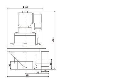

ÐͺŹæ¸ñÑ¡Ôñ±í
ÐòºÅ
ÐͺŹæ¸ñ
¹«³ÆÍ¨¾¶
ĤƬÊý
³öÆø¿ÚÁ¬½ÓÐÎʽ
ÖØÁ¿
Inch
mm
1
DMF-Z-20
3/4"
20
1
G 3/4 "
0.65kg
2
DMF-Z-25
1"
25
1
G 1"
0.8kg
3
DMF-Z-40S
1 1/2"
40
2
G 1 1/2"
1.4kg
4
DMF-Z-50S
2"
2
G 2"
2.4kg
5
DMF-Z-62S
2 1/2"
62
2
G 2 1/2"
3.5kg
6
DMF-Z-76S
3"
76
2
G 3 "
4.3kg
7
8
DMF-2L-B
3/4""
20
1
27
