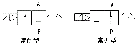

¶þλ¶þͨĤƬʽµç´Å·§
²ÉÓñê×¼Q/YS02
¶þλ¶þͨĤƬʽµç´Å·§ÊÇÏÖ´ú»¯¹¤Òµ¹ÜµÀÖеĿª¹ØÔª¼þ£¬ÀûÓõç´ÅÎüÁ¦ºÍ½éÖʵŤ×÷ѹ²î£¬Íê³ÉϵͳÖÐÆøÌå¡¢ÒºÌå¡¢ÓÍÆ·¡¢ÈõËá¡¢Èõ¼îµÈ¸÷ÖÖ½éÖʵÄ×Ô¶¯¿ØÖÆ¡£

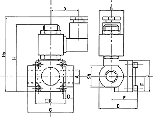

<> ÍâÐͳߴç
ÐͺŠW A B C D E F G H J K L R T
0927000 0955105 G1/4 18 50 12 55 100 55 22 91 113 33.5 47 52 30
0927100 0955205 G3/8
0927200 0955305 G1/2
0927300 0955405 G3/4 22 90 116 70 30 100 130 42 65
0927400 0955505 G1
0927500 0955605 G11/4 18 134 94 48 125 158 85
0927600 0955705 G11/2
0927700 0955805 G2 20 160 115 56 138 178 110
