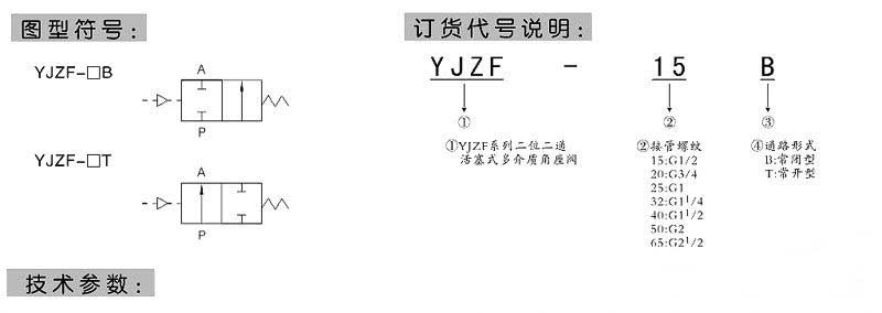

YJZF¶à½éÖʽÇ×ù·§
¶©»õºÅ
½Ó¹ÜÂÝÎÆ
(G)
¹«³ÆÍ¨¾¶
(mm)
KvÖµ
(m3/h)
×î´ó¹¤×÷ѹÁ¦
(MPa)
ÒªÇó×îС¿ØÖÆÑ¹Á¦
(MPa)
Ö´ÐÐÆ÷³ß´ç
(Ømm)
³£±ÕÐÍ
³£¿ªÐÍ
²»Ðâ¸Ö
²»Ðâ¸Ö
YJZF-15B
YJZF-15T
G1/2
13
4.2
0~1.6
0.39
YJZF-20B
YJZF-20T
G3/4
20
8
0~1.1
0.39
YJZF-25B
YJZF-25T
G1
25
19
0~1.1
0.42
63
YJZF-32B
YJZF-32T
G1 1/4
32
27.5
0~1.5
0.5
80
YJZF-40B
YJZF-40T
G1 1/2
40
42
0~1.25
0.44
100
YJZF-50B
YJZF-50T
G2
55
0~1.1
0.32
125
YJZF-65B
YJZF-65T
G2 1/2
65
90
0~0.52
0.32
125

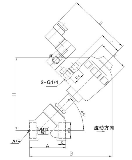

×¢£ºG1 1/4, G1 1/2 G2 ͨ¾¶µÄ½Ç×ù·§ÔÚÑ¡ÔñÖ´ÐÐÆ÷³ß´çΪ63ʱ£¬ÒÔÉÏÁ÷¶¯·½Ïò¼ýÍ·Ïà·´
½Ó¹ÜÂÝÎÆ
(ØD)
¹«³ÆÍ¨¾¶
(mm)
Ö´Ðгߴç (mm)
A
B
C
ØE
F
G
H
¾Ûõ£°±
¾Ûõ£°±
¾Ûõ£°±
¾Ûõ£°±
¾Ûõ£°±
¾Ûõ£°±
G1/2
13
85
173
12
64
44
112
137
G3/4
20
95
178
12
64
44
112
145
G1
25
63
105
212
14
80
52
120
173
G1 1/4
32
63
142
236
16
80
52
120
189
G1 1/2
40
63
130
230
18
80
52
120
189
G2
63
150
238
20
80
52
120
205
G2 1/2
65
250
22
