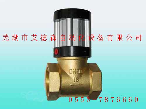

Q22HDϵÁÐÁ÷Ì寸¿Ø·§
²úƷ˵Ã÷
¸Ã·§Æô¶¯Ñ¹Á¦µÍ£¬¹Ø±ÕÁéÃô¶È¸ß£¬ÃÜ·âÐÔÄܺ㬽ø³ö¿Ú·½ÏòÈÎÒâ¡£
ÖÖÀà·Ö½ØÖ¹Ê½¡¢Õ¢°åʽ¡¢Ë«Î»ÖÃÁ÷Á¿¿Éµ÷ʽµÈ¶àÖֽṹ¡£Ïֹ㷺
Ó¦ÓÃÔÚʳƷ¡¢Ò½Ò©¡¢¹¤Òµ¡¢Ï´µÓ¡¢Ê¯»¯¡¢Ò±½ð¡¢ÅçÍ¿¡¢³µÁ¾µÈ»ú
еÉ豸ÉÏ¡£
