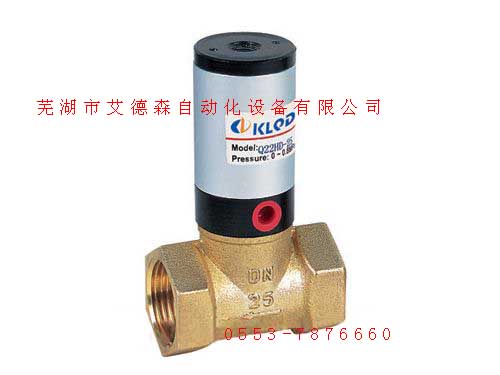

²úÆ·ÐͺÅ: Q22HD-25
²úÆ·Ãû³Æ: Q22HD-25 µç´Å·§
Q22HDϵÁÐÁ÷Ì寸¿Ø·§
²úƷ˵Ã÷
¸Ã·§Æô¶¯Ñ¹Á¦µÍ£¬¹Ø±ÕÁéÃô¶È¸ß£¬ÃÜ·âÐÔÄܺ㬽ø³ö¿Ú·½ÏòÈÎÒâ¡£
ÖÖÀà·Ö½ØÖ¹Ê½¡¢Õ¢°åʽ¡¢Ë«Î»ÖÃÁ÷Á¿¿Éµ÷ʽµÈ¶àÖֽṹ¡£Ïֹ㷺
Ó¦ÓÃÔÚʳƷ¡¢Ò½Ò©¡¢¹¤Òµ¡¢Ï´µÓ¡¢Ê¯»¯¡¢Ò±½ð¡¢ÅçÍ¿¡¢³µÁ¾µÈ»ú
еÉ豸ÉÏ¡£
²ÎÊý
ÐͺÅ
Q22HD-15
Q22HD-20
Q22HD-25
Q22HD-35
Q22HD-40
Q22HD-50
¹«³ÆÍ¨¾¶
15
20
25
40
½Ó¹ÜÂÝÎÆ
G1/2¡±
G3/4¡±
G1¡±
G11/4¡±
G11/2¡±
G2¡±
¹¤×÷½éÖÊ
¿ÕÆø£¬Ë®£¬ÓÍ£¬Òº»¯Æø£¬Çᶯճ¶ÈÁ÷Ìå
¹¤×÷ѹÁ¦
0.2~0.6Mpa
½éÖʺͻ·¾³Î¶È
5~50¡æ
Á÷Á¿ÏµÊýKVÖµ
4
5
10
25
40
ÐͺÅ
A
B
C
D
H
M
Q22HD-15
46
26
¦Õ30
G1/2¡±
96
G1/8¡±
Q22HD-20
54
32
¦Õ37
G3/4¡±
107
G1/8¡±
Q22HD-25
66
34
¦Õ37
G1¡±
118
G1/8¡±
Q22HD-35
80
53
¦Õ65
G11/4¡±
162
G1/8¡±
Q22HD-40
80
53.6
¦Õ65
G11/2¡±
162
G1/8¡±
Q22HD-50
105
66
¦Õ78
G2¡±
180
G1/4¡±
