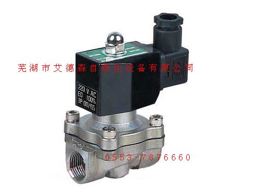

²úÆ·ÐͺÅ: 2WB-15
²úÆ·Ãû³Æ: 2WB-15 µç´Å·§
ÌØµã
1.²ÉÓÃÖ±¶¯Ê½Ä¤Æ¬½á¹¹ÎÞѹÁ¦Æô¶¯£¬À©³äÁËÆäʹÓÃÁìÓò¡£
2.²ÉÓÃÆ½°åʽĤƬ½á¹¹Æô±Õ¿É¿¿£¬²¢ÔöÇ¿Á˸òúÆ·µÄʹÓÃÊÙÃü¡£
3.Ñ¡ÓÃËÜ·âÏßȦ¿ÉÌá¸ß¸Ã²úÆ·ÔÚÖÚ¶à»·¾³Ïµİ²È«Ê¹Óá£
¼¼Êõ²ÎÊý
씀²ÎÊý
ʹÓýéÖÊ
´¿Ë®£¬ÈõËᣬÈõ¼î΢¸¯Ê´ÐÔ½éÖÊ
¶¯×÷·½Ê½
Ö±¶¯Ê½
ÐÍʽ
ĤƬʽ
ѹ²î·¶Î§
0~1.0Mpa
¹«³ÆÑ¹Á¦
1.0Mpa
½éÖÊζÈ
-5~80¡æ
»·¾³Î¶È
-5~60¡æ
°²×°·½Ê½
ÈÎÒâ
Ñ¡Óõçѹ
AC380V£¬220V£¬110V£¬36V£¬24V
DC220£¬110V£¬36V£¬24V£¬12V
¹æ¸ñ
ÐͺÅ
Á¬½Ó
³ß´ç
ͨ¾¶
(mm)
CvÖµ
ѹ²î·¶Î§
(MPa)
ÏßȦ¹¦ÂÊ
  VA
ÍâÐγߴç
L
H
D
2WB-15
G1/2¡±
16
4.8
0~1.0
14
70
100
93
2WB-20
G3/4¡±
20
7.6
0~1.0
14
73
102
100
2WB-25
G1¡±
25
12
0~1.0
14
100
106
104
2WB-35
G11/4¡±
35
28
0~0.7
125
158
141
2WB-40
G11/2¡±
40
28
0~0.7
125
158
141
2WB-50
G2¡±
48
0~0.7
167
168
157
