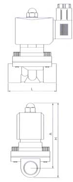

 ¡¾Ñ¡Óùæ¸ñ¡¿
ÐͺŠÁ¬½Ó
³ß´ç
ͨ¾¶ CvÖµ ѹ²î·¶Î§ ÏßȦ¹¦ÂÊ ÍâÐγߴç
L H  A
2WB-15 G1/2¡å 16 4.8 0~1.0 14 70 100 93
2WB-20 G3/4¡å 25  7.6 0~1.0 14 73 102 100
2WB-25 G1¡å 25 12 0~1.0 14 100 106 104
2WB-35 G11/4¡å 40 28 0~0.7 50 125 158 141
2WB-40 G11/2¡å 40 28 0~0.7 50 125 158 141
2WB-50 G2¡å 50  48 0~0.7 50 167 168 157
