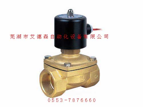

²úÆ·ÐͺÅ: 2WC-50
²úÆ·Ãû³Æ: 2WC-50³£¿ªµç´Å·§
2WCϵÁг£¿ªÊ½Í¨Óõç´Å·§
ÌØµã
1. ÒËʹÓÃÓÚÁ÷ͨµãʱ¼ä½Ï³¤µÄ¿ØÖÆÁìÓò
2. ²ÉÓÃÖ±¶¯Ê½Ä¤Æ¬½á¹¹£¬È·±£³£¿ªÊ½µç´Å·§ÔÚÎÞѹÁ¦×´Ì¬Ï¿ɰ²È«Æô¶¯¡£
3. ¶àÖÖÏßȦ¼°²ÄÖÊÑ¡Ôñ¿ÉΪ¿Í»§ÌṩÀíÏëµÄ²úÆ·¡£
¼¼Êõ²ÎÊý
씀²ÎÊý
ʹÓýéÖÊ
Ë®£¬¿ÕÆø£¬ÓÍ£¬Íß˹
¶¯×÷·½Ê½
Ö±¶¯Ê½
ÐÍʽ
ĤƬʽ¡¢³£¿ªÊ½
ʹÓÃÁ÷ÌåÕ³ÖͶÈ
20CSÒÔÏÂ
ѹ²î·¶Î§
0~1.0Mpa
¹«³ÆÑ¹Á¦
1.0Mpa
½éÖÊζÈ
-5~80¡æ
»·¾³Î¶È
-5~60¡æ
°²×°·½Ê½
ÈÎÒâ
Ñ¡Óõçѹ
AC380V£¬220V£¬110V£¬36V£¬24V
DC220V£¬110V£¬36V£¬24V£¬12V
¹æ¸ñ
ÐͺÅ
Á¬½Ó
³ß´ç
ͨ¾¶
(mm)
Cv
Öµ
ѹ²î·¶Î§
(MPa)
ÏßȦ¹¦ÂÊ
VA
2WC-15
G1/2¡±
16
4.8
0~0.8
13
2WC-20
G3/4¡±
20
7.6
0~0.8
13
2WC-25
G1¡±
25
12
0~0.8
13
2WC-35
G11/4¡±
35
24
0~0.8
20
2WC-40
G11/2¡±
40
28
0~0.8
         20
2WC-50
G2¡±
48
0~0.8
20
