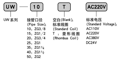

¡ö ͼÐηûºÅ
¡ñ ¶©¹º´úÂë
¡ö ÌØ³¤

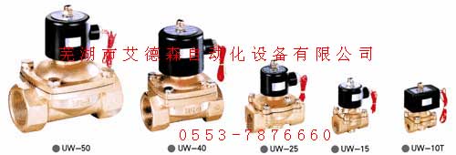

    ²ÉÓÃĤƬÃÜ·â½á¹¹£¬¾ßÓÐÁãѹ²îÆð¶¯¹¦ÄÜ¡£Á÷Á¿´ó£¬½á¹¹¼òµ¥¡¢Î¬ÐÞÈÝÒס£ÓÅÁ¼µÄ·ÀË®ÐÔÄÜ¡£ÅäÏß·½ÏòÁé»î¡£µç´Å·§UW-10,µç´Å·§UW-15,µç´Å·§UW-20,µç´Å·§UW-25,µç´Å·§UW-40,µç´Å·§UW-50

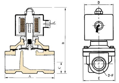

¡ö ÍâÐγߴç
¹æ¸ñ
A
B
C
D
E
F
UW-10/UW-10T
69
117
16
¦Õ50
57
ZG3/8
UW-15/UW-15T
69
117
16
¦Õ50
57
ZG1/2
UW-20/UW-20T
73
124
17
¦Õ50
57
ZG3/4
UW-25/UW-25T 99 135 23 ¦Õ50 73 ZG1
UW-35 123 172 30 ¦Õ70 95 ZG11/4
UW-40 123 172 30 ¦Õ70 95 ZG11/2
UW-50 168 209 37 ¦Õ70 123 ZG2
