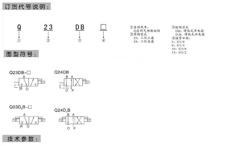

²úÆ·Ãû³Æ£º
Q23DB-8»¬°åʽµç´Å·§
ÐÍ ºÅ£º
0.00
2614
Ïêϸ˵Ã÷£º
ÐÍ ºÅ
Q23DB-6 Q24DB-6
Q23DB
2
-6 Q24DB
2
-6
Q23DB-8 Q24DB-8
Q23DB
2
-8 Q24DB
2
-8
Q23DB-10 Q24DB-10
Q23DB
2
-10 Q24DB
2
-10
Q23DB-15 Q24DB-15
Q23DB
2
-15 Q24DB
2
-15
¹¤×÷ѹÁ¦ (MPa)
0.15-0.8
ÊÊÓÃÎÂ¶È (¡ãC)
-5~50
¹«³ÆÍ¨¾¶
6
8
10
15
Á÷ͨÄÜÁ¦ (mm
2
10
20
40
60
×î¸ß»»ÏòƵÂÊ (Hz
8
8
µçѹ·¶Î§ (V
AC:220, 110V, 36V; DC: 24, 12V, µçѹ²¨¶¯·¶Î§ÔÊÐíΪ¶î¶¨µçѹµÄ-15~+10%
ÊÙÃü (Íò´Î)
>=300
ÂÝÎÆ½Ó¿Ú
G1/8
G1/4
G3/8
G1/2
