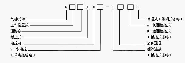

Ò»¡¢ÐͺÅ

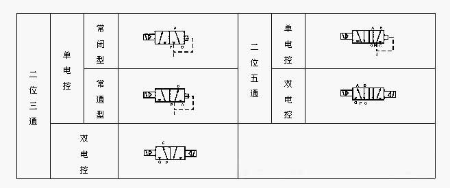

¶þ¡¢Í¼ÐηûºÅ

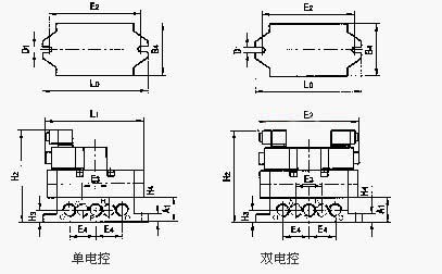

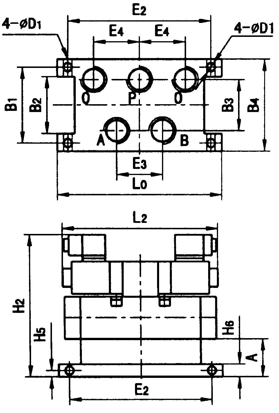

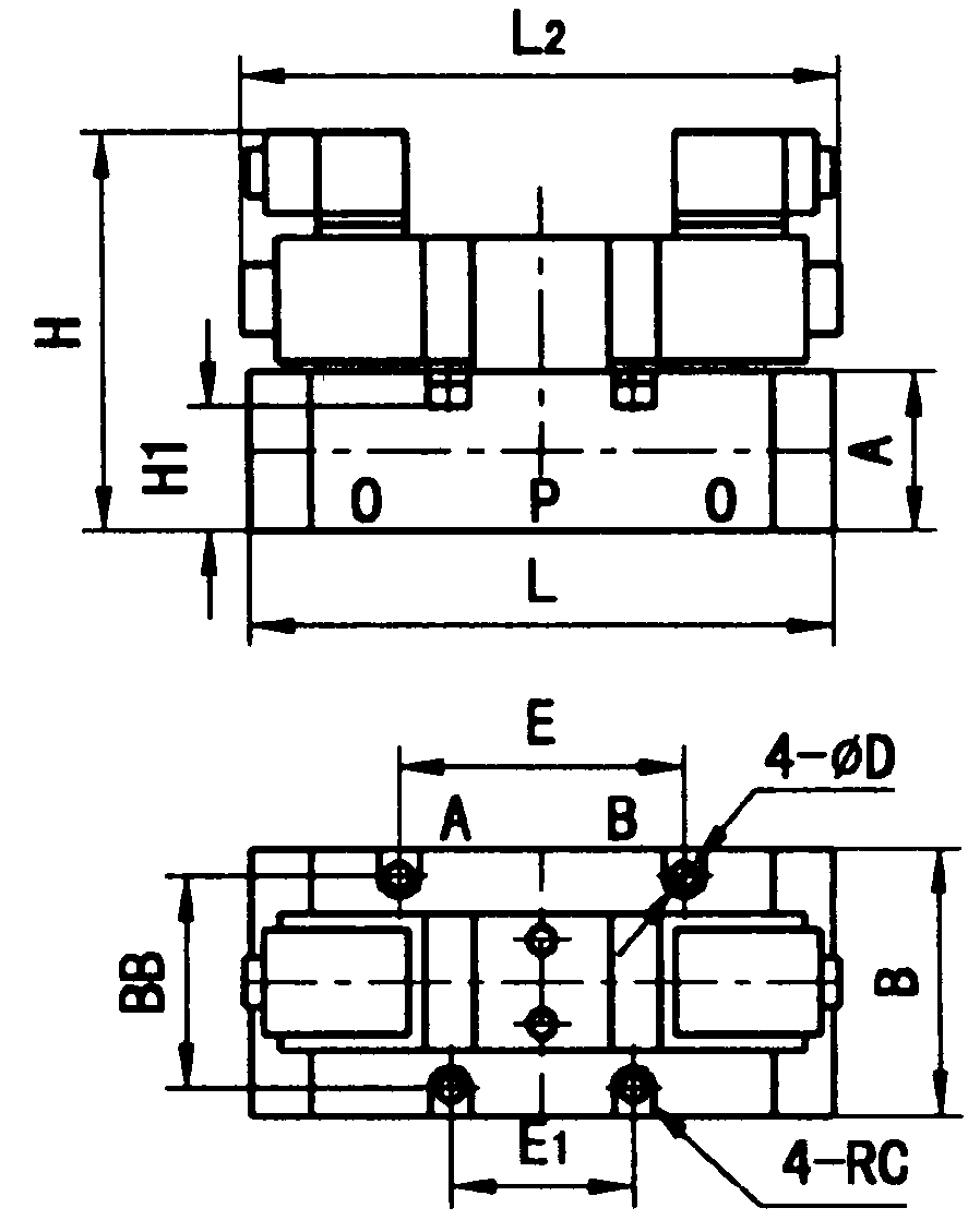

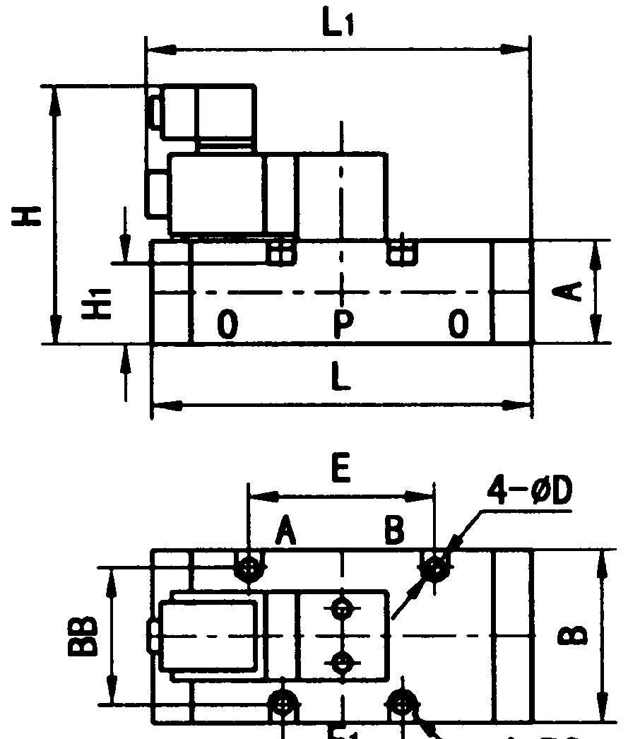

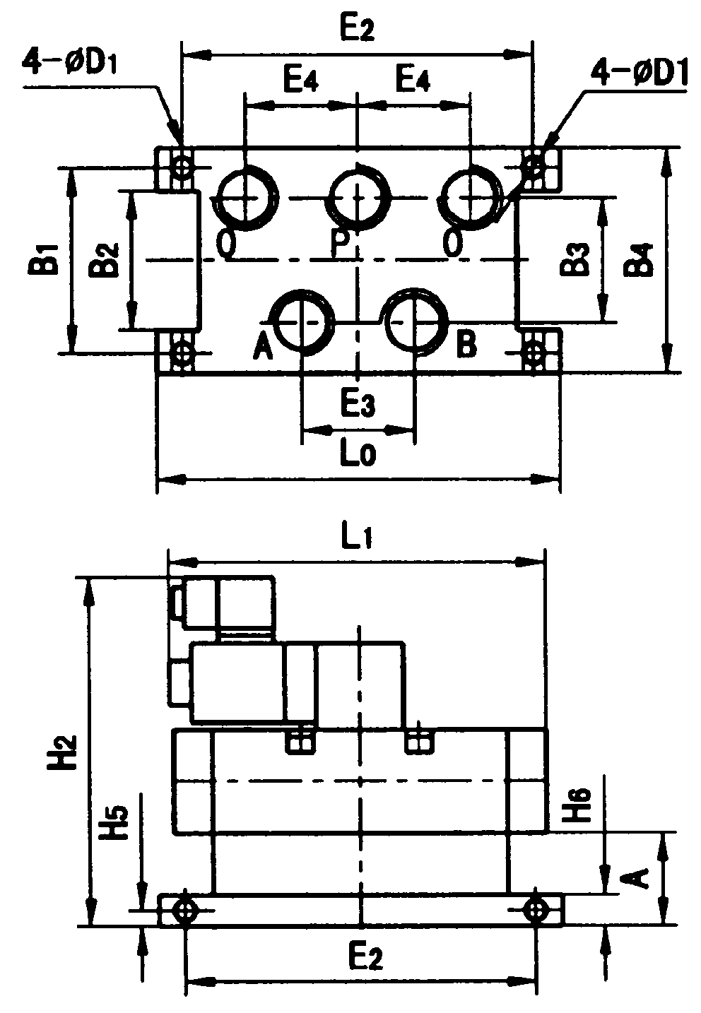

   ±¾·§µÄ°²×°ÐÎʽÓÐÈýÖÖ£¬°å½Óʽ¡¢²àÃæ¹Ü½ÓʽºÍµ×Ãæ¹Ü½Óʽ¡£°²×°³ß´ç¼ûͼ¼°³ß´ç±í¡£
      ²àÃæ¹Ü½Óʽ
           µ¥µç¿Ø                      Ë«µç¿Ø
      µ×Ãæ¹Ü½Óʽ
           µ¥µç¿Ø                       Ë«µç¿Ø
ͨ¾¶
A
A1
B
BB
B0
B1
B2
B3
B4
C
D
D1
E
E1
E2
E3
E4
20
57.5
60
74
58
102
82
62
48
88
8.5
8.5
9
80
40
160
54
49
25
57.5
60
74
58
102
82
62
48
88
8.5
8.5
9
80
40
160
54
49
32
77.5
76
88
68
132
110
88
62
100
11
10.5
11
100
208
70
65
40
77.5
76
88
68
132
110
88
62
100
11
10.5
11
100
208
70
65
ͨ¾¶
H
H1
H2
H3
H4
H5
H6
L
L0
L1
L2
½Ó¿ÚÂÝÎÆ
ISO°²×°Ãæ¹æ¸ñ
ABP¿Ú
O¿Ú
20
128
36.5
188
27
14
10
20
163
180
171
178
G3/4¡¨
G3/4¡¨
4
25
128
36.5
188
27
14
10
20
163
180
171
178
G1¡¨
G3/4¡¨
4
32
159
53.5
235
35
16
11
22
197
230
205
212
G11/4
G11/4
5
40
159
53.5
235
35
16
11
22
197
230
205
212
G11/2¡¨
G11/4
5
