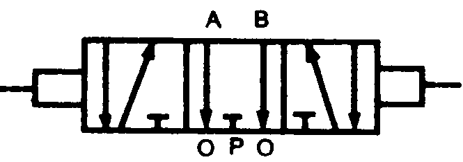

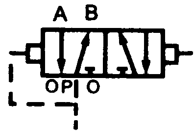

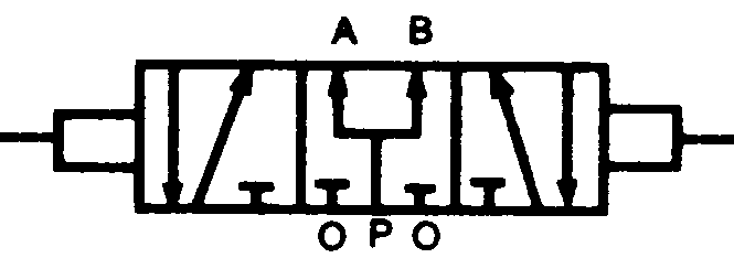

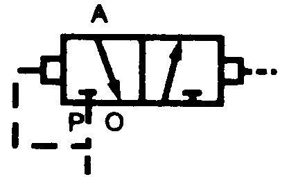

Ò»¡¢ÐͺÅQ25QC¡¢Q25Q2CϵÁÐÆø¿Ø»»Ïò·§

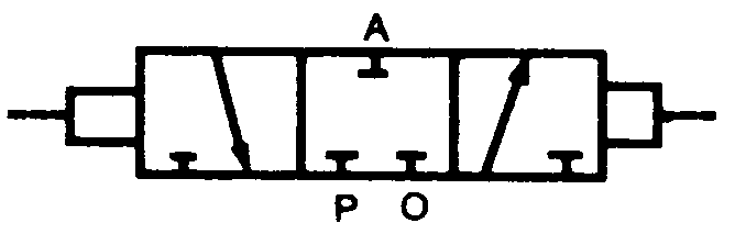

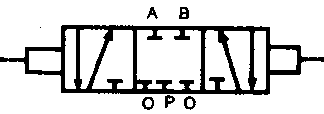

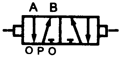

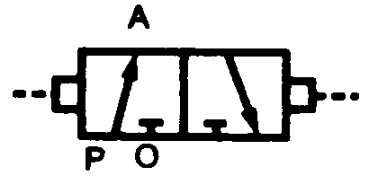

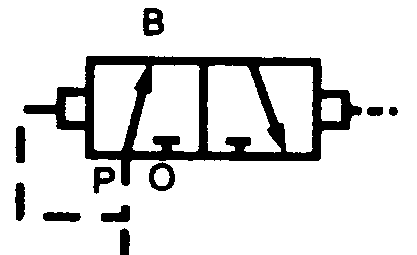

¶þ¡¢Í¼ÐηûºÅ
¶þ
λ
Èý
µ¥
Æø
¿Ø
³£±ÕÐÍ
Èýλ
Èýͨ
·â±ÕÐÍ
³£Í¨ÐÍ
Èý
λ
Îå
¼ÓѹÐÍ
Ë«Æø¿Ø
ÅÅ¿ÕÐÍ
¶þ
λ
Îå
µ¥Æø¿Ø
·â±ÕÐÍ
Ë«Æø¿Ø

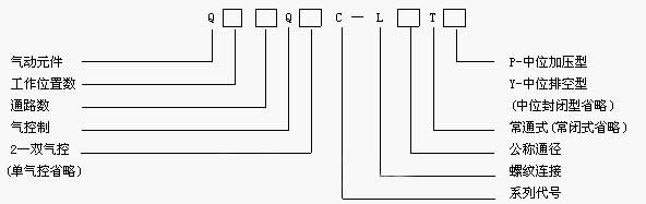

¿Ø»»Ïò·§Q25QC-L8¡¢Æø¿Ø»»Ïò·§Q25QC-L10¡¢Æø¿Ø»»Ïò·§Q25QC-L15¡¢Æø¿Ø»»Ïò·§Q25QC-L20¡¢Æø¿Ø»»Ïò·§Q25QC-L25¡¢Æø¿Ø»»Ïò·§Q25Q2C-L8¡¢Æø¿Ø»»Ïò·§Q25Q2C-L10¡¢Æø¿Ø»»Ïò·§Q25Q2C-L15¡¢Æø¿Ø»»Ïò·§Q25Q2C-L20¡¢Æø¿Ø»»Ïò·§Q25Q2C-L25ϵÁÐÆø¿Ø»»Ïò·§
QQCϵÁÐÆø¿Ø»»Ïò·§
1¡¢ QDCϵÁеÄÅÉÉú²úÆ·¡£ÓÃÆøÑ¶ºÅ¿ØÖÆ£¬ÊÊÓÃÓÚ²»ÔÊÐíµçÔ´´æÔڵij¡ºÏ¡£
2¡¢ ÎÞ¸øÓÍ£¨Ò²¿É¸øÓÍ£©È󻬣¬±ÜÃâÓÍÆøÎÛȾ£¬¿ÉʡȥÓÍÎíÆ÷¡£
Q23QC-L3T      Q23Q2C-L3       Q25Q2C-L3       Q35Q2C-L3P
Q23QC-L3       Q23Q2C-L6       Q25Q2C-L6       Q35Q2C-L6P
Q23QC-L6T      Q23Q2C-L8       Q25Q2C-L8       Q35Q2C-L8P
Q23QC-L6       Q23Q2C-L10      Q25Q2C-L10      Q35Q2C-L10P
Q23QC-L8T      Q23Q2C-L15      Q25Q2C-L15      Q35Q2C-L15P
Q23QC-L8       Q23Q2C-L20      Q25Q2C-L20      Q35Q2C-L20P
Q23QC-L10T     Q23Q2C-L25      Q25Q2C-L25      Q35Q2C-L25P
Q23QC-L10      Q25QC-L3        Q33Q2C-L3       Q35Q2C-L3Y
Q23QC-L15T     Q25QC-L6        Q33Q2C-L6       Q35Q2C-L6Y
Q23QC-L15      Q25QC-L8        Q33Q2C-L8       Q35Q2C-L8Y
Q23QC-L20T     Q25QC-L10       Q33Q2C-L10      Q35Q2C-L10Y
Q23QC-L20      Q25QC-L15       Q33Q2C-L15      Q35Q2C-L15Y
Q23QC-L25T     Q25QC-L20       Q33Q2C-L20      Q35Q2C-L20Y
Q23QC-L25      Q25QC-L25       Q33Q2C-L25      Q35Q2C-L25Y
