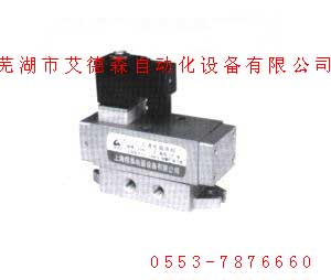

²úÆ·Ãû³Æ£º K25D-20.K25D-25.K25D-40µ¥µç¿Ø»¬·§
ÐÍ ºÅ£º
Æ· ÅÆ£º 2614
Ïêϸ˵Ã÷£º
£±¡¢½á¹¹¼òµ¥£¬Ó¦Óù㷺¡£
£²¡¢¹Ü½Ó¡¢°å½Ó£¬°²×°·½±ã¡£
£³¡¢Æ·ÖÖ¡¢¹æ¸ñÆëÈ«£¬ÈÎÒâÑ¡Ôñ¡£

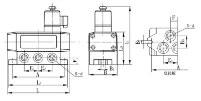

Îå¡¢ÍâÐμ°°²×°³ß´ç£º
ÐͺŠd d1 L L1 L3 A B B1 B3 B4 E2 E3 F L2
K25D-6(8) M10*1
(M12*1.25)
(M14*1.5)
M10*1 140.5 129.5 132 112 56 9 24 16 28 37 14 68
K25D2-6(8) 149
K35D2-6(8)
150.5 137.5 148
K25D-10(15)
M16*1.5
M18*1.5
(M20*1.5)
(M22*1.5)
M10*1 168 161 166 146 74 9 33 18 38 49 19 90
K25D2-10(15)
170 170
K35D2-10(15)
182 178 188
K25D-20(25)
M27*2
(M33*2)
M10*1 243 210 243 202 112 11 52 35 60 70 30 129
K25D2-20(25)
234 234
K35D2-20(25)
252 229 252
