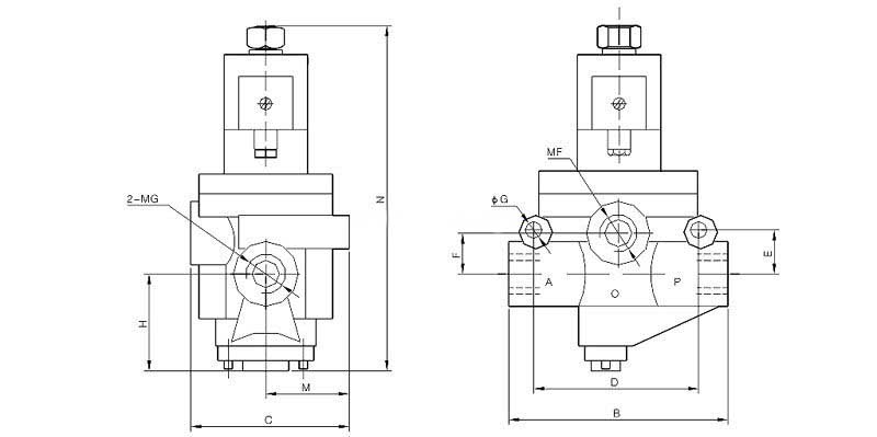

K23JD-8W   K23JD-8TW
96
78
73
17
16.5
9
45
39
G1/4
M12X1.5
G2/8
M16X1.5
170
K23JD-10W   K23JD-10TW
G3/8
M16X1.5
G1/2
M20X1.5
K23JD-15W   K23JD-15TW
G1/2
M20X1.5
G1/2
M20X1.5
K23JD-20W   K23JD-20TW
113
89
82
24
21
9
52
38
G3/4
M27X2
G1
M33X2
190
K23JD-25W   K23JD-25TW
G1
M33X2
G1
M33X2
K23JD-32W   K23JD-32TW
165
121
118
37
37.5
13
75
46
G1 1/4
M42X2
G1 1/2
M48X2
260
K23JD-40W   K23JD-40TW
G1 1/2
M48X2
G1 1/2
M48X2
