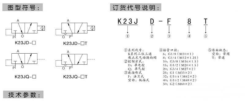

K23JD-8
K23JD-15
ÐÍ ºÅ
K23JD-6
K23JD-6T
K23JQ-6
K23JQ-6T
K23JD-8
K23JD-8T
K23JQ-8
K23JQ-8T
K23JD-10
K23JD-10T
K23JQ-10
K23JQ-10T
K23JD-15
K23JD-15T
K23JQ-15
K23JQ-15T
K23JD-20
K23JD-20T
K23JQ-20
K23JQ-20T
K23JD-25
K23JD-25T
K23JQ-25
K23JQ-25T
K23JD-F32
K23JD-F32T
K23JQ-F32
K23JQ-F32T
K23JD-F40
K23JD-F40T
K23JQ-F40
K23JQ-F40T
K23JD-F50
K23JD-F50T
K23JQ-F50
K23JQ-F50T
¹«³ÆÍ¨¾¶ (mm)
6
8
10
15
20
25
32
40
¹¤×÷ѹÁ¦ (MPa)
0.15~0.8
й©Á¿ (cm3/min)
=<10
=<10
=<25
=<25
=<50
=<50
=<70
=<70
=<70
»»Ïòʱ¼ä (S)
=<0.04
=<0.04
=<0.06
=<0.06
=<0.1
=<0.1
=<0.15
=<0.15
=<0.2
Çл»ÆµÂÊ (Hz)
>=10
>=10
>=8
>=8
>=4
>=4
>=3
>=3
>=2
»·¾³ÎÂ¶È (¡ãC)
-10~55
½éÖÊÎÂ¶È (¡ãC)
-5~50
Á÷ͨÄÜÁ¦SÖµ (mm2)
>=10
>=20
>=40
>=60
>=120
>=190
>=300
>=400
>=650
µçÔ´µçѹ (V)
AC: 220, 110, 36, DC: 48, 24, 12 µçѹ²¨¶¯ÔÊÐíΪ¶î¶¨ÖµµÄ+10%~-15% , Æø¿ØÎÞ±¾Ïî²ÎÊý
ÊÙÃü (Íò´Î)
>=150

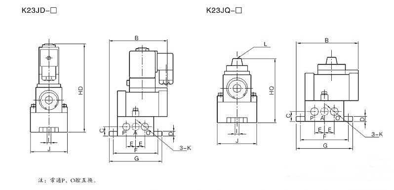

ÐͺÅ
½Ó¹ÜÂÝÎÆ K
B
C
D
E
F
G
HD
HQ
I
J
L
K23JD-6
K23JQ-6
G1/8 (M10X1)
90
14
7
14
68
80
134
91
7
56
G1/8
K23JD-8
K23JQ-8
G1/4 (M12X1.25)
K23JD-10
K23JQ-10
G3/8 (M16X1.5)
125
19
10
19
86
100
155
111
7
64
K23JD-15
K23JQ-15
G1/2 (M20X1.5)
K23JD-20
K23JQ-20
G3/4 (M27X2)
180
30
12
30
130
162
218
149
11
100
K23JD-25
K23JQ-25
G1 (M33X2)

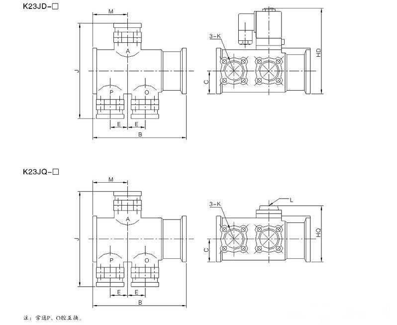

ÐͺÅ
½Ó¹ÜÂÝÎÆ K
B
C
E
HD
HQ
J
L
M
K23JD-F32
G1  1/4 (M42X2)
215
52.5
40
197
130.5
218
G1/8
80
K23JQ-F32
K23JD-F40
G1  1/2 (M48X2)
215
52.5
40
197
130.5
218
80
K23JQ-F40
K23JD-F50
G2 (M60X2)
265
65
45
222
155
258
101
