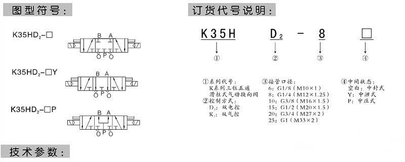

Ïêϸ˵Ã÷£º
»¬Öùʽ»»Ïò·§K35HD2-8
»¬Öùʽ»»Ïò·§K35HD2-15
ÐÍ ºÅ
K35H
D2
Q2
- 6
6Y
6P
K35H
D2
Q2
- 8
8Y
8P
K35H
D2
Q2
- 10
10 Y
10 P
K35H
D2
Q2
- 15
15 Y
15 P
K35H
D2
Q2
- 20
20 Y
20 P
K35H
D2
Q2
- 25
25 Y
25 P

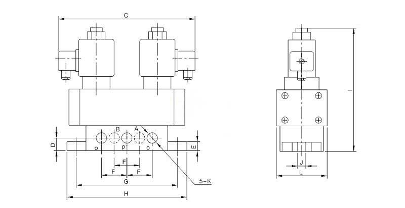

ÐͺÅ
½Ó¹ÜÂÝÎÆ K
C
D
E
F
G
H
I
J
L
K35HD2-6
G1/8 (M 10X1)
153
14
10
28
112
130
136
9
56
K35HD2-8
G1/4 (M 12X1.25)
K35HD2-10
G3/8 (M 16X1.5)
184
19
14
38
143
164
159
9
74
K35HD2-15
G1/2 (M 20X1.5)
K35HD2-20
G3/4 (M 27X2)
254
25
15
60
202
234
229
11
112
K35HD2-25
G1 (M 33X2)
