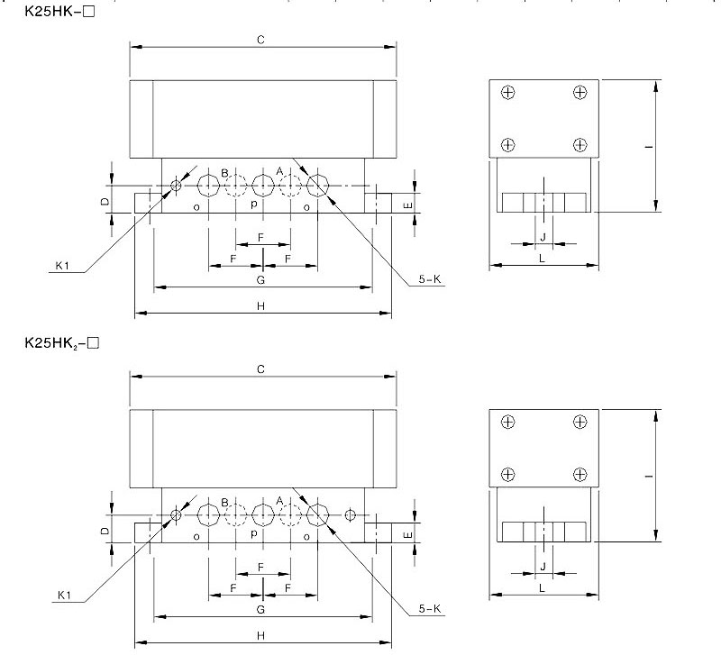

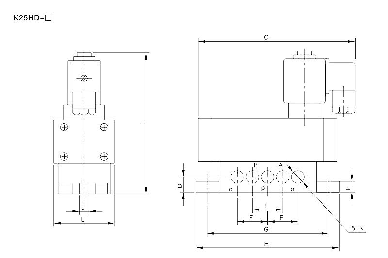

¡ú K25HD2-25»¬Öùʽ»»Ïò·§
²úÆ·Ãû³Æ£º
ÐÍ ºÅ£º
0.00
2614
Ïêϸ˵Ã÷£º
»¬Öùʽ»»Ïò·§
K25HD
2
-25
ÐͺÅ
½Ó¹ÜÂÝÎÆ K
C
D
E
F
G
H
I
J
L
K25HD-6
G1/8 (M 10X1)

ÐͺÅ
½Ó¹ÜÂÝÎÆ K
C1
C2
E
E
F
G
H
I
J
L
K1
K25HK-6
K25HK
2
-6
G1/8 (M 10X1)
130
130
147
10
28
112
130
130
9
56
M10
K25HK
2
-8
G1/4 (M 12X1.25)
K25HK-10
K25HK
2
-10
G3/8 (M 16X1.5)
161
171
19
14
38
146
164
165
9
74
K25HK-15
K25HK
2
-15
G1/2 (M 20X1.5)
K25HK-20
K25HK
2
-20
G3/4 (M 27X2)
241
230
125
15
60
202
234
210
11
112
K25HK-25
K25HK
2
-25
G1 (M 33X2)

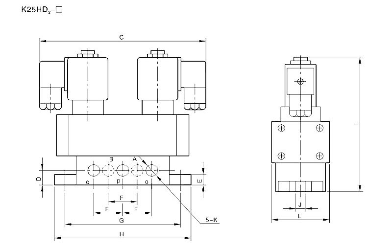

ÐͺÅ
½Ó¹ÜÂÝÎÆ K
C
D
E
F
G
H
I
J
L
K25HD
2
-6
G1/8 (M 10X1)
160
14
10
28
112
130
130
9
56
K25HD
2
-8
G1/4 (M 12X1.25)
K25HD
2
-10
G3/8 (M 16X1.5)
171
19
14
38
146
164
165
9
74
K25HD
2
-15
G1/2 (M 20X1.5)
K25HD
2
-20
G3/4 (M 27X2)
230
25
15
60
202
234
210
11
112
K25HD
2
-25
G1 (M 33X2)

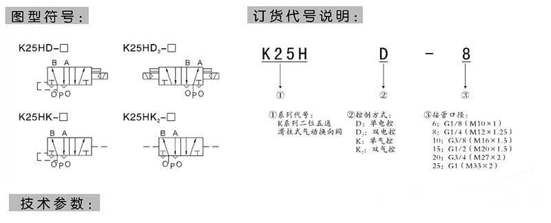

ÐÍ ºÅ
K25HD-6
K25HD
2
-6
K25HK-6
K25HK
2
-6
K25HD-8
K25HD
2
-8
K25HK-8
K25HK
2
-8
K25HD-10
K25HD
2
-10
K25HK-10
K25HK
2
-10
K25HD-15
K25HD
2
-15
K25HK-15
K25HK
2
-15
K25HD-20
K25HD
2
-20
K25HK-20
K25HK
2
-20
K25HD-25
K25HD
2
-25
K25HK-25
K25HK
2
-25
